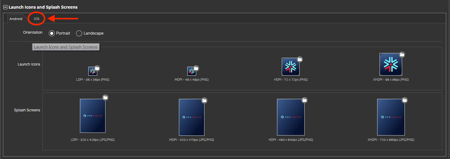

Im using latest version of intel xdk which is incorporated with cordova 5.1.1. I built an application by adding all splashscreen for ios in build settings and also i added cordova splashscreen plugin but i'm still getting cordova as my application splash screen. Please let me know the solution or fix for this.

PaulF_IntelCorp
2,894 Views
Yeoyong -- the splash screen config image you show is for Android devices. You have to click the "iOS" tab to configure the splash screens for your iPad and other Apple devices. See the image below:

yeoyong_l_
2,894 Views
hi
sorry for uploading the wrong screenshot, i have upload a new screenshot
