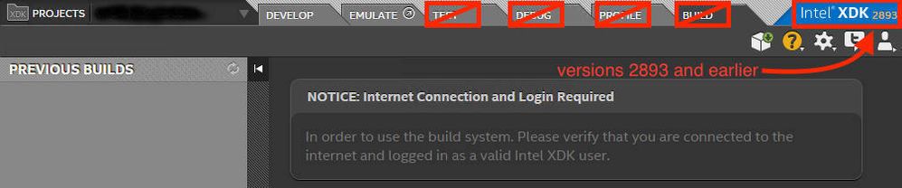

Important note about Intel XDK versions 2893 and older!
Versions of the Intel XDK released prior to March 2016 (2893 and older) can no longer use the Build tab, the Test tab or App Preview and can no longer be used to create custom debug modules for use with the Debug and Profile tabs. This change was necessary to improve the security and performance of our Intel XDK cloud-based build system. If you are currently running version 2893 or older, of the Intel XDK, you must upgrade to the latest version of the Intel XDK!!
