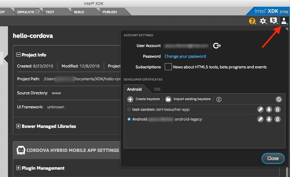

siv b. wrote:
i have installed it when i creata a project it take too long time to create , i am waiting for 15 to 20 minute still saying "DOWNLOADING SELECTED TEMPLATE OR SAMPLE" , simply cannot create a project without any problem , we cannot wait too long to create a project
Have you tried this from a different network connection? We do not have any other reports of such a problem, and we are unable to reproduce the issue. The servers are responding quickly, my suspicion is you are having difficulties installing the Cordova plugins that are used by those samples.
I just tested creation of a new project using the "hello cordova" sample. Each time I tried it the whole process took about one minute to complete. There are several screens that appear during the process, the three that last the longest are shown below, in the order they appear. Which one is the one that you are seeing for hours?

@paul
Hi, its been a while I updated any of my apps on the playstore and I am trying to do that at the moment.
In the reference video of "Upgrading an existing project to Ver. 3088", the caution sign shows "only legacy certificate(s) found." as shown in the 3rd image below.
In my version 3759, the caution sign shows "No certificate found." as in the image below.
I have opened over 10 projects and all show; " No certificate(s) found."
Kindly advise on how to get the certificate i can use for the playstore.
I created a new certificate/keystore and i get this error message when i try to upload the apk to the playstore.
You uploaded an APK that is signed with a different certificate to your previous APKs. You must use the same certificate.
Your existing APKs are signed with the certificate(s) with fingerprint(s):
The second image illustrates that.
Kindly advise on next steps.
PaulF_IntelCorp
5,590 Views
Alfred:
Do any of the following conditions apply to you?
  • If you are using an account that was created subsequent to the 3088 release, there will be no legacy certificate available to convert.
  • If you are using an account that was created prior to the 3088 release, and never converted the legacy certificate, it should be available to convert using the certificate manager (the first image shown below, the name "android-legacy" was created by me when I converted mine, that is not automatic).
  • If you previously converted your legacy certificate, and then deleted it (using the "garbage can" icon), you need to put it back (assuming you downloaded it using the "down arrow" icon), using the "Import existing keystore." If you deleted it and did not download it, you will not be able to put it back.
  • If you used a different account to build those apps (prior to 3088) and are now using a new account, you need to login using the old account to see your legacy certificate (assuming you did not previously convert it and delete it) or put the old one back that you converted and downloaded (if you did that with the old one).
What do you see when you go here? (see the image below):
You will see the same list when you select the "Developer Certificate" option:
Alfred_B_1
5,100 Views
  • If you are using an account that was created subsequent to the 3088 release, there will be no legacy certificate available to convert. My account was created late 2014
  • If you are using an account that was created prior to the 3088 release, and never converted the legacy certificate, it should be available to convert using the certificate manager (the first image shown below, the name "android-legacy" was created by me when I converted mine, that is not automatic). This is my case, but the icon in question for conversion is not visible.
  • If you previously converted your legacy certificate, and then deleted it (using the "garbage can" icon), you need to put it back (assuming you downloaded it using the "down arrow" icon), using the "Import existing keystore." If you deleted it and did not download it, you will not be able to put it back. I never converted the legacy certificate. i only remember creating a new one a few days ago when i updated.
  • If you used a different account to build those apps (prior to 3088) and are now using a new account, you need to login using the old account to see your legacy certificate (assuming you did not previously convert it and delete it) or put the old one back that you converted and downloaded (if you did that with the old one).  I have only one account.
What do you see when you go here? (see the image below): In my case, there is no list.
You will see the same list when you select the "Developer Certificate" option: There is just no list there.
That's the issue. I don't have the option to convert a legacy certificate.
