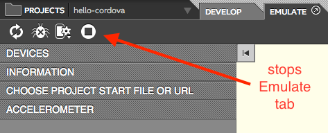

@Tawab -- you mentioned "with the debugger open" -- do you mean the debugger in the Emulate tab or the debugger in the Debug tab? Assuming you mean the debugger in the Emulate tab, if you close the debugger before you move to another tab, does that prevent the crashes? Have you tried using the Debug tab as an alternative to the Emulate tab? It will actually provide a better debug environment. Please watch this webinar for a demo > https://software.intel.com/en-us/xdk/videos/debug-tab-html5-apps-debugging-using-the-intel-xdk
@Aya -- if you push the button in this image you can "stop" the Emulate tab. I recommend doing this before you leave the Emulate tab to see if that fixes the crash problems you're having:

Paul F. (Intel) wrote:
@Tawab -- you mentioned "with the debugger open" -- do you mean the debugger in the Emulate tab or the debugger in the Debug tab? Assuming you mean the debugger in the Emulate tab, if you close the debugger before you move to another tab, does that prevent the crashes? Have you tried using the Debug tab as an alternative to the Emulate tab? It will actually provide a better debug environment. Please watch this webinar for a demo > https://software.intel.com/en-us/xdk/videos/debug-tab-html5-apps-debuggi...
@Paul, No that doesn't prevent the crashes unfortunately.
I tried using the debugger in the debug tab, but for some reason intel XDK will not find my device, I've tried everything (all the troubleshooting tips) to no avail. -> (mainly the reason why I use the debugger in the emulate tab that often)
