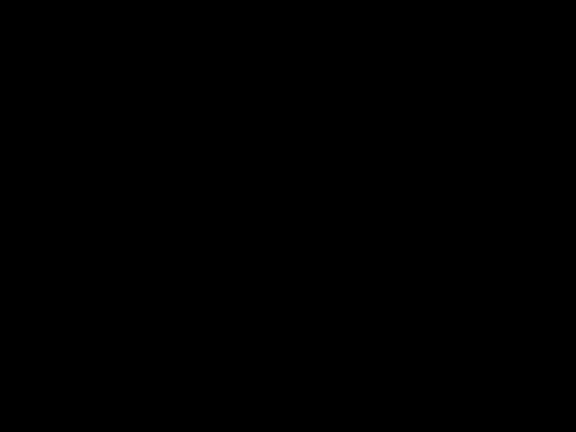

So I have managed to write an image but it is blank :S
The camera light is coming on until script ends so making progress, any ideas to push this one forward anyone ?
#include "opencv2/opencv.hpp"
#include "opencv2/highgui/highgui.hpp"
#include <iostream>
using namespace cv;
using namespace std;
int main(int, char**)
	VideoCapture cap(-1);
    if (!cap.isOpened())  // if not success, exit program
        cout << "Cannot open the video cam" << endl;
        return -1;
    } else {
        cout << "Opened Cam" << endl;
	Mat save_img; cap >> save_img;
	if(save_img.empty())
		cout << "Something is wrong with the webcam, could not get frame." << endl;
	} else {
		cout << "Writing Image." << endl;
		imwrite("test.jpg", save_img); // A JPG FILE IS BEING SAVED
		cout << "Written Image test.jpg" << endl;
	return 0;
root@quark00a8ee:~# chmod 755 /tmp/TASS;/tmp/TASS ;exit
VIDIOC_QUERYMENU: Invalid argument
Opened Cam
select timeout
Writing Image.
logout

OK last update need to sleep lol.
#include <iostream>
using namespace cv;
int main(int, char**){
    if (!cap.isOpened()){
        return -1;
    } else {
	Mat frame; cap >> frame;
	bool bSuccess = cap.read(frame);
	if (!bSuccess){
		cout << "Cannot read a frame from video stream" << endl;
		return -1;
	} else {
		cout << "Read a frame from video stream" << endl;
	cout << "Writing Image" << endl;
	imwrite("bleh.png", frame);
	cout << "Image Written " << endl;
	return 0;
Gives me:
Opened Cam
select timeout
select timeout
Writing Image
Image Written
logout
And black image still

code looks ok - maybe try specifying the camera in VideoCapture (e.g. set to '0' = default, or to '1', ..., '99'). Maybe you're on a "/dev/zero" kind of camera?
You could write a quick OpenCV program to scan through the cameras to get a list of existing ones

Hi thanks I have downloaded it will check it out, have you any idea why the image is black ?
