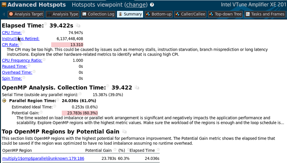

An up-to-date VTune can show you load imbalance assigned to each OpenMP parallel region, which will let you see where the problems are. This is described in this article.
Here is the kind of information it generates, note that it shows serial time, the parallel time, and the load imbalance.
