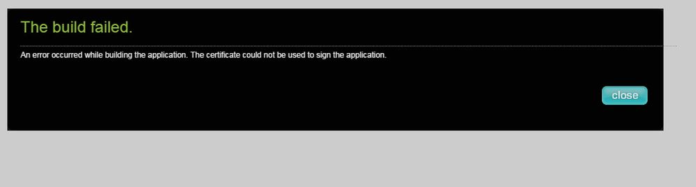

I have a problem creating iOS apps . Follow the instructions
- Produced in windows
Failed Build

How do I create iOS applications. I followed the instructions but it's not working . When creating writes error - Failed Build = 1 image. We apologize for my English language

Are you sure you are using a DISTRIBUTION certificate and a provisioning profile that is associated with that certificate?
Are you able to build a simple iOS cordova app?

Can you post a screenshot of  the issue you are seeing?

filmed two videos in a row

1. The first video the (at least the first issue) issue is that you correctly created a distribution certificate, however, whatever provisioning profile you have included is not valid. You must make the provisioning profile AFTER you make the distribution cert. If you look at the apple developer portal, it will say that the provisioning profile is Invalid/Expired.
2. The second video is way off. There is a difference between the Cordova build (first video) and the Legacy builds (part of the second video). When you click the build tab, you are given the option to build Cordova or Legacy builds. The Legacy builds will soon be going away all together, so stay away from them. They are old, outdated, and not really maintained, hence the removal soon.
Stick to building the Cordova iOS app and try giving what I told you in step 1. a try and report back with results.
