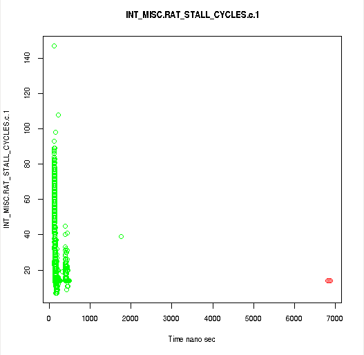

amir k. wrote:
false
It is interesting what really happens at machine code level around ~100 nano seconds. There is big spike of RAT_STALLS event(s) , but there is no way how to map those events to executed assembly code.
@amir
Can you tell me how this screenshot correlates to executed code? I mean time frame with 1e+3 nano sec step resolution corresponds to main() function or to the prologue of your timer function?

@amir
In my previous post I quoted your response #21 , but screenshot was not posted.

4. The posted figure shows that "RAT_STALL" cycles dominate in the "normal" iterations, and are quite small in the long duration iterations.  So this counter is not helpful if you are trying to understand the cause of the long iterations.
