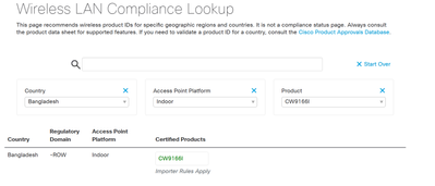

- @Shamol The WLC 9800 must be running software version IOS-XE 17.18.1 for 6Ghz support in Bangladesh
(check it out, or have it checked)
M.
Checked, supported in BD.
It is broadcasting 6GHz and connected with Apple Device.
- @Shamol Wireless Lan Compliance Lookup table is only for access points ;
Execute : show version | inc 17 on the WLC 9800 for full version verification (still advised)
