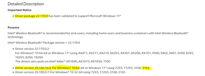

I noticed that the Bluetooth driver installed on your system is 10.0.19041.1
How come? From IDSA:
And in Device Manager:
Matching this: https://www.intel.com/content/www/us/en/download/18649/742233/intel-wireless-bluetooth-for-windows-10-and-windows-11.html
As I wrote earlier: I restored the OS to the state from 12/10 by re-imaging the OS partition using backup created then. Everything was fine since 12/10 (and obviously before) until Fri 21/10 and I've not changed or altered any drivers.
I also kept all drivers up to date as they were released by HP & vendors (including yourselves).
I will therefore appreciate your further thoughts on this and how to troubleshoot this tricky situation further.

Since OEM drivers are handpicked, customized, and validated to resolve platform-specific issues, enable features and enhancements, and improve system stability, I recommend you install their latest version with a clean installation.
I did try and install SP107300 (download links here: https://support.hp.com/gb-en/document/c06961543) yesterday and to the same result. IDSA obviously was stating that it's out-of-date driver.
(As a side note: please note that as this driver is >2 years old, there might have been vulnerabilities discovered in that version of BT driver that might have been resolved by the later releases, hence me always using the latest available one - and for quite some time either - with no issues at all until last week)
Furthermore:

Thanks - but I've done it numerous times already - and please also do remember that the larger task at hand was a complete OS restore to the time when all was well (t-10 days) - and all to no avail.
So I guess problem lies elwewhere and I am more than motivated to get to the bottom of it.
It almost feel that the fault lies with Microsoft routines extensions, i.e. AVRCP Transport, A2DP SNK etc. that are not being correctly picked up and installed when device is re-paired and connected to the computer.
