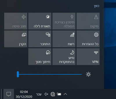

DaniC
5,748 Views
Hello Alberto,
When did you purchase the laptop? October 2019, Unfortunately the warranty ended two months ago.
Was it working fine before? YES.
Did you make any recent hardware? NO.
Did you make any recent software changes?
NO, Not intentionally.
But the day I first noticed the problem, I saw that my laptop was restarted.
I had a few open documents that disappeared when the computer woke up.
I'm guessing Windows installed some update that day.
The wireless card, did you purchased it separately or did it came installed on the computer? Came installed on the computer.
Does the problem happen at home or work environment? Home.
I have attached some screenshots of the Device Manager.
"Before" refers to a state where everything is working properly.
"After" refers to the state after restarting the computer.
If anything is unclear, ask me and I will translate for you.
ASUS has 2 categories for network drivers.
"Network" and "Wireless".
I tried them all.
1. Why does the AC-9560 appear as available (refer to SSU after)? This is clearly not the case.
2. My BIOS is in LEGACY mode, NOT UEFI. I didn't change anything, it was the default. I guess I can change that somehow to UEFI.
Thank you!
