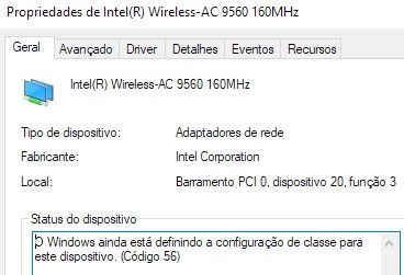

After the wifi installation failed, I tried to install it again and it finished with no error, BUT, my Wifi Network Adapter now doesn't work. Looking at de device manager and checking its properties, it shows:
"Windows is still setting up the class configuration for this device. (Code 56)"
The two virtual adapter from VMWare are also reporting the same problem.
I tried to remove the device (and driver versions) but it didn't help. I removed the antivirus, VMWare and OpenVPN, and tried to reinstall the intel wifi driver, but it didn't help either. I removed the bluetooth driver, but it also didn't help.
I tried to "Reset Network" in Windows 10, and after that, all the devices (including the realtek network controller) stopped to work and started to report Code 56. So I did a system restore to at last get the realtek controller working again. Unfortunately, I don't have a restore point before the failed attempt of installing the driver update, so I cannot restore the system to the previously "working" environment.

2. Can you provide a screenshot of the Device Manager showing the error message?

I do have a screenshot showing the error:

I had a system image generated by EaseUS Todo Backup from one month ago, and I restored that image. I could not use the Windows's System Restore feature because there was no restore point dated before the faulty installation was done.
