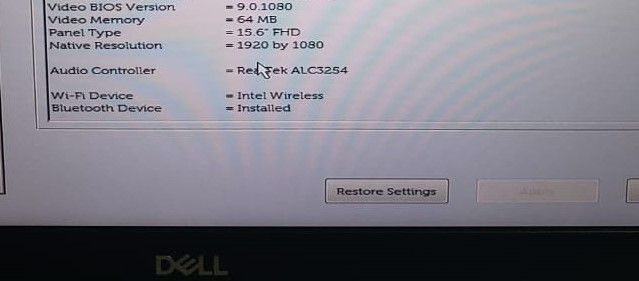

Guys, good afternoon!
A few days ago my wifi stopped working. In reality, it is flashing. Sometimes it works when turning on the notebook, sometimes not. Sometimes it works when restarting and sometimes it doesn't.
When it doesn't work, it just disappears from the machine. It's like it doesn't even exist.
In the device settings it does not appear and in the windows network settings there is no wifi option.
When restoring the wireless settings directly in the bios, it returns. But when you turn off or restart the note, it disappears again ...
I have already made several configurations (update drive, reinstall, go back to old version, clear cache, update Windows, update bios dell, reconfigure wlan, etc. etc.) and all without permanent success. Sometimes it works and sometimes it doesn't.
When it works, it runs perfectly ... with speed and without falling.
I did a test on the board from the CMD and the result is that the hardware is working. The problem appears to be software.

2. It was working perfectly without any problems. It stopped working after two situations:
A) installation of Karspersky Internet Security (3 days before);
B) Punctually after a period of suspension of the machine during the night. The other day, I came back to finish my tasks and I didn't have Wifi anymore. Since then, it has flashed (time recognizes and works normally, time does not recognize). The bios itself indicates whether or not it is recognized and whether it will work or not after windows starts.
3. Current version as indicated by Dell's (22.20.0.6 of 11/30/2020) and two others that I do not remember the code, one of 01/2020 and the other of 07/2020). The three remained with the same intermittency.
4. The error code I can see in the device manager is 45 (hardware device not connected to the computer).
See in the images that when entering Bios, it recognizes the wireless card or not. If you recognize it, it works 100%. If not, I don't have wifi and I need to restart or disconnect and connect again until I recognize it.
I made some power settings, based on information I found on the internet, which prevent the suspension of the computer and the wireless card. I'm testing...
I have already reinstalled windows as suggested by microsoft support, but the blinking remained.
I also tested the wireless card from Dell's check and the result was positive.

Jup2
4,190 Views
unfortunately my problem persists. I made some modifications to the windows settings for sleep and power, but the problem remains the same. help me please!!!
