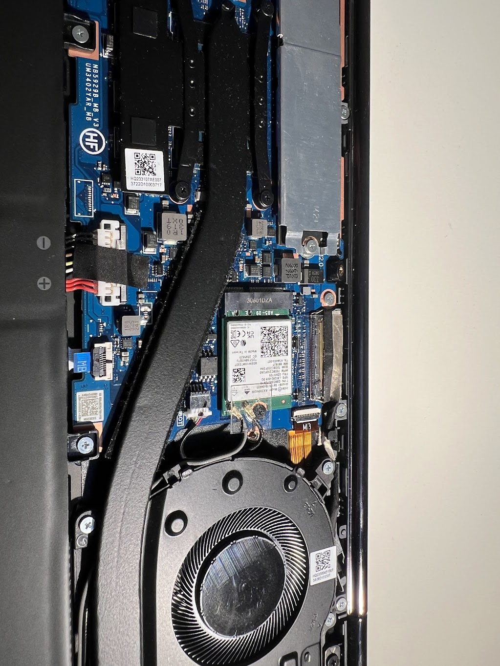

> In our continued efforts to understand your setup, we would also like to inquire about the installation process of the PCIE adapter. If you could provide photographs of the adapter and its installation on your laptop, it would greatly aid us in comprehending your configuration.
Please find the photos attached, I hope it helps. The process was straight forward:
- open notebooks case
- locate the PCIE adapter
- remove protection sticker
- remove antenna connectors
- unscrew the fixation screw
- remove the old adapter
- insert the new adapter
- fix the screw
- attach antenna cables
- attach protection sticker
- close notebook case
Let me know if you need to know anything else.
