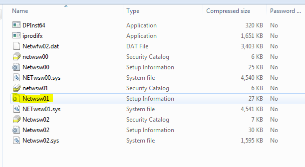

I FOUND IT, I FOUND IT!!!
https://smartpctools.com/drivers/Intel(R)_Centrino(R)_Wireless-N_Win7x64.html
OK so you download the Zip folder (in small letters under download it says "download driver manually" click that!)
Then unzip the file and navigate through the folders \acer_n2dd1d55fdedc.zip\Wireless LAN_Intel_18.12.0.3_W7x64\Drivers\Win7
in the Win 7 folder use Netwsw01:
Navigate to this file from Device manager using this walk through: https://www.tp-link.com/us/support/faq/228/
AND BAM! YOU GOT WIFI AGAIN! (hopefully)

I am glad you have the problem solved. However, be very cautious about using these 3rd party driver sites as you never know what payload the driver will contain.
