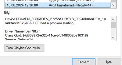

  • Hello, my ASUS TUF GAMING F15 FX506HM laptop for the past few months has been having issues with wifi, the connection drops, unable to connect, and even if it's connected it is really slow. I have deleted and updated drivers several times.

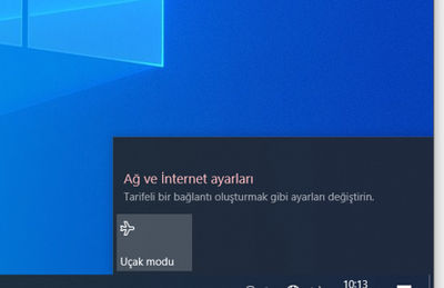

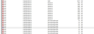

Hey im having the same problem right now
1. attached
2. YES it does show me on bar before disappearing and reconnecting again
3. it even happens when nothing is running
4. no signs of overheating
i have been troubleshooting a lot
reinstalled the drivers multiple times
deactivated firewalls
ethernet connection stopped working as well( might be a different problem - it says no ip configuration; couldnt fix with troubleshooting as well)
checked the network settings and adjusted multiple times after reinstalling drivers

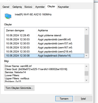

After analyzing the pictures that you have shared together with the logs, here are the possible reasons to your problem:
1.  Wireless Driver Corruption
2. Operation System Corruption
3. Hardware faulty.
To check if it is a Wireless Driver Corruption
Kindly do the instructions listed on this article, Intel® Wireless Adapter Keeps Disconnecting from the Network. Please note that updating the BIOS of your system may be best conducted by any technical representative of your laptop manufacturer.
The driver on your system gets to an error message. For this reason, please try the steps listed on this article, Codes 10, 22, 28, 31, 43 or 45 Errors in Device Manager for Bluetooth® or Wireless (Wi-Fi) Devices. I want to highlight the Cold Reboot and Resetting BIOS to defaults are the most effective steps on that article.
Should the recommendations on both articles fail, please reach out to your laptop manufacturer to have the hardware checked or Operating system reset to defaults.
