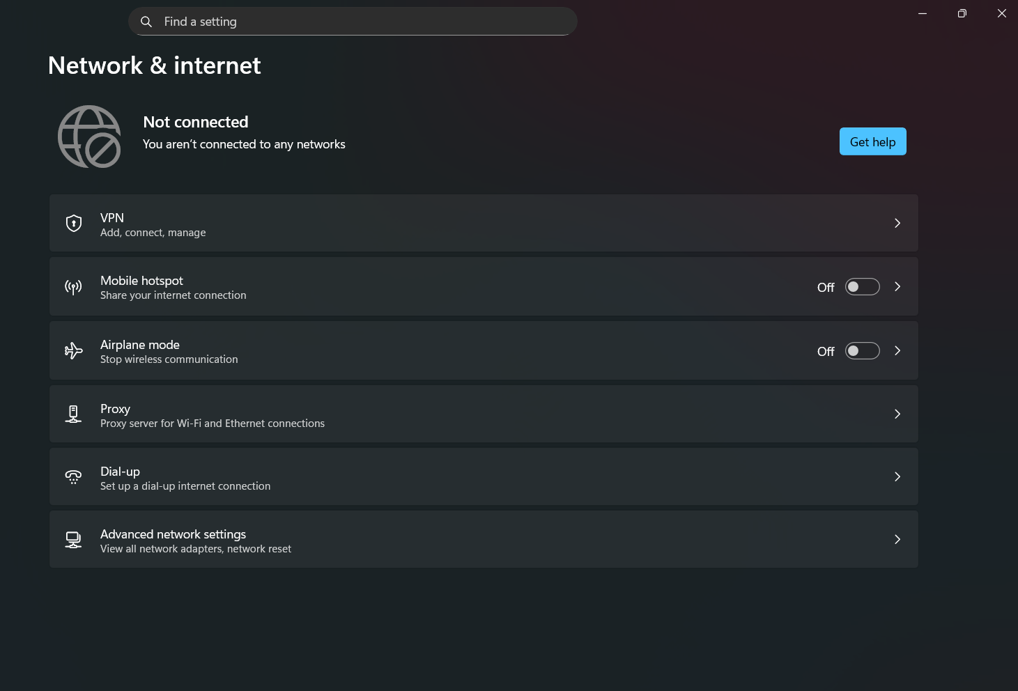

I haven't been able to see my Wi-Fi option in my Windows 11 for the last 2 months. I have attached the SSU output for reference.

  4. When you say you "haven't been able to see my Wi-Fi option in my Windows 11" does it mean the wireless adapter is not visible inside device manager (under network adapter)? If it is visible, can you check and share the status of the device?

  4. When you say you "haven't been able to see my Wi-Fi option in my Windows 11" does it mean the wireless adapter is not visible inside device manager (under network adapter)? If it is visible, can you check and share the status of the device? ::-
    It is visible in Device Manager but showing an error. I’m sharing a screenshot for reference, and I can’t see the Wi-Fi option anywhere in the settings even after the 23.150.0.4 update.

Hello Shailove,
An Error Code 10, 22, 28, 31, 43, or 45 in Device Manager can occur when:
  • Bluetooth cannot be enabled
  • In Device Manager, there is a Yellow bang (!, exclamation point) next to the Bluetooth or Wireless (Wi-Fi) device
  • In Device Manager, the properties of the Bluetooth or Wireless device shows status = "This device cannot start. (Code 10) STATUS_DEVICE_POWER_FAILURE”
Intel recommends that you test using your Original Equipment Manufacturer (OEM) drivers. If you still get the error after reinstalling these drivers, then try the Intel generic drivers for Bluetooth or Wireless adapters.

Please follow the steps below for the fix:
1) Ensure that there are no pending Windows Updates.
2) Download the latest OEM and/or Intel generic drivers:
  • OEM driver: version 22.90.1.1 (Recommended)
  • Intel driver: version 23.150.0.4
3) Perform Clean Installation of Wireless Drivers. *Clean installation of the wireless/Bluetooth drivers is a troubleshooting step recommended to remove any previous installation files that might cause conflicts with new driver installations.
4) Perform a Cold reboot of the system after reinstalling the driver.

Shailove
890 Views
still facing the same issue

JeanetteC_Intel
655 Views
Hello Shailove,
We released a new wireless driver version 23.160.0.4 on August 26, 2025. Please do a clean driver installation and perform a cold reboot afterward.
Should the problem persist, please reach out to your system manufacturer's support team for further hardware troubleshooting.
