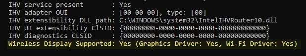

Hello Mike, we download driver over the time directly from HP site for our device HP 840 G7, we also tried the same thing downloading the driver from intel site but nothing changes.
Also yes, the problem persists with the latest driver.
thanks

Hello Mike, we also tried in another pc (we have this problem in multiple pcs) with the clean installation but nothing change, here the thing, we start from this situation (miracast1.png) then we found that we have this:
47AC.7718::07/18/25-14:18:28.6940813 [server] - --> WimInit
47AC.7718::07/18/25-14:18:28.7005186 [server] - Init: enable soft AP or not: 1
47AC.7718::07/18/25-14:18:28.7005190 [server] - Init: enable WFD or not: 0
47AC.7718::07/18/25-14:18:28.7005218 [vlib] - --> VLibSetVirtualization
47AC.7718::07/18/25-14:18:28.7005222 [vlib] - Asked to program virtualization se
- On a test device. Please remove the AllowWFD registry key at the Registry path
HKLM\SOFTWARE\Microsoft\WlanSvc\
- Since we have many devices affected, it is recommended to implement a script or Group Policy to automate the removal of the key.
- Setting the key to 0 disables Wireless Display (WFD).
- If the key is present with a value of 1 or 10000000, WFD is considered enabled.
- The preferred configuration is for the key to be not present. Therefore, deletion is the recommended approach.
- The presence of this key on the affected systems suggests that it was manually set in the past, as it is not created by default.
This is why im thinking that this driver on the frist installation, also create this key.
thanks

Hello Max1995,
Thank you for the update.
I may have this issue check by our Engineer so please help provide a detailed information below:
- How many units are affected?
- Are the affected units having the same brand and model? Meaning the SSU that you provided before are the same for the affected units?
- Just to clarify, no issue with Wi-Fi connection? The issue is when using Miracast?
- If you can also provide a video of the issue, that would help in my simulation.
