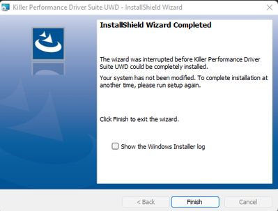

When I try and install the Killer Performance Suite v3.1121.1159 it says "The wizard was interrupted before Killer Performance Driver Suite UWD could be completely installed." Please help me fix this error.

When installing the new driver I custom picked what I want installed (Disabled the other drivers 3xxx and it fixed it the issue for me. And only installed 2xxx version)  So try installing only your version and unchecking the rest.

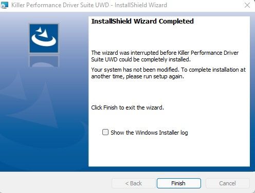

5.) Please share a screenshot of the error.

A_Skiba
7,300 Views
I have encountered the same issue.
Through trial and error, using the custom install I tried installing every driver package and they all installed successfully on their own and along side the others, except for the 3100 drivers. The 3100 drivers where the only ones resulting in an installation error when selected either on their own or along side any combination of the other drivers.
The rest of the drivers were installed without any problems both alone and with each other, and this has also updated my Intel Driver & Support Assistant to show my drivers and software are up to date.

Thank you all for the visibility. In this case, the recommendation for this issue is to perform a custom installation as some of the users have mentioned before, keep the necessary drivers and disable the ones that are not for your system. Also please confirm if that workaround works for you @Vinny5353
David G
donb2022
7,165 Views
Yep, doing the custom installation worked for me.

Before we close the case, please use the latest driver on the Intel® Killer™ Performance Suite released on the Jan 14th that comes with the fix.
