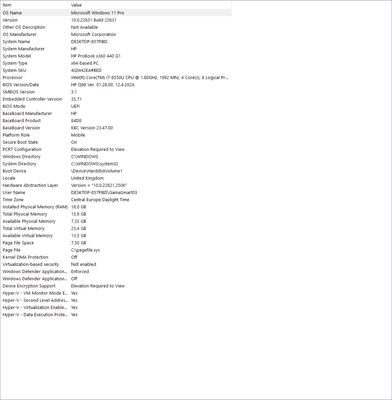

Hi, I finally find network cable, I will upgrade bios and oem driver and will try speed test again and let you know.
drasko982
2,214 Views
Hi Von, sorry for my late answer.
I've update bios version:
I've updated wifi driver from the link https://www.intel.com/content/www/us/en/download/777192/intel-wireless-wi-fi-drivers-for-intel-dual-band-wireless-ac-8260-and-intel-dual-band-wireless-ac-8265.html
I've tried with network cable (disabled wifi) and here is result of test:

sorry I missunderstand. I've installed hp wlan driver:
Restarted my laptop and upload is still stucked on 3mb/s.
