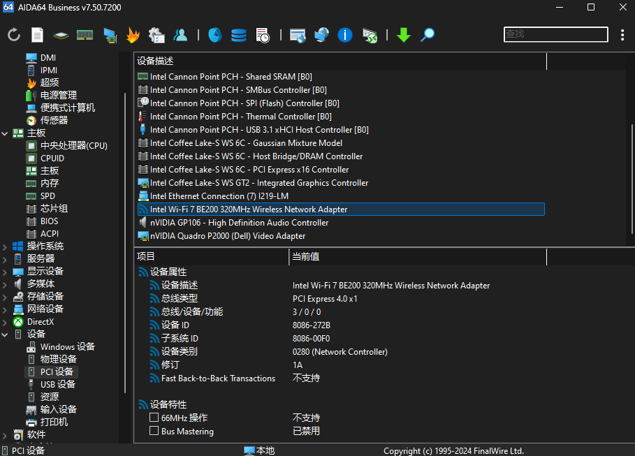

AIDA64After installing the latest Intel driver 23.120.0 on the DELL workstation (Intel chipset C246), my BE200 network card cannot be enabled. When I downgraded to version 23.10.0.2, my network card was still able to drive, but the Bluetooth module was driving normally in my PC Device Manager without any issues. However, I am unable to open it in Windows 11 settings. What problem have I encountered. Dell Workstation Details: model: Precision3630 CPU: Intel Xeon E-2146G GPU:NVIDIA P2000 5G BIOS: 2.33.0 (latest version in April this year) Windows version: Windows 11 Professional Edition Windows version number: 23H2 Windows system version: 22631.5039 Windows Experience Version: 1000.2270.1074.0

Unfortunately, even with the official DELL driver, I am unable to successfully drive my BE200 wireless network and Bluetooth. This network card is an additional one that I purchased, and I noticed that my BE200 version is 001. Is there any incompatibility between this version of the network card and the new driver?
I have already sent my SSU file in the attachment, please help me check which ones may cause this issue.
And I noticed that my southbridge chipset version is C246, which is mentioned in Intel's documentation as supporting Intel SST (Smart Sound) technology. However, I cannot see it in the system devices in Device Manager, enable Intel Smart Sound OED and bus, or support LE Audio properly. Is there a solution to this?

Hey, I saw some errors in the event manager on my Windows, I wonder if I can improve the issue with the network card driver for you:
1. Unable to allocate resources required for the operation
2. The system determines that the operation mode of the network adapter is inappropriate
3. The network adapter returns invalid values to the driver program
These errors all occurred in Netwaw16, do they indicate that this 23.120 driver is not compatible with my BE200?

Thank you for your answer:
As far as I know, except for the inability to enable the 6GHZ band, the rest of the BE200 functions can be used normally in mainland China; before upgrading from AC9520 to BE200, I removed all Intel wireless drivers in the operating system, and after installing BE200, I downloaded the matching drivers from Intel's BE200 details page; when I failed to drive BE200 for the first time, I sent a consultation to the DELL China Community (the relevant link is attached at the end), and followed the community's answer to me and performed the operation, but it still failed; this computer was installed with Windows 10 when it left the factory, and I downloaded the new version of the 24H2 image from the Microsoft official website for installation; while waiting for your reply on April 29, I had already performed a clean installation and installed the 23.130 driver (it was not marked as "latest" at the time), but unfortunately, I still couldn't drive it normally.
After that, I tried to install BE200 on my Lenovo LEGION Y7000 2019 PG0 laptop. Previously, this laptop was updated from AC9560 to AX200 without any abnormality. However, after BE200 was installed, I installed the latest driver from Intel's official website, and still received the same error and log prompt as my DELL desktop, but the 23.10 driver can be enabled correctly.So please continue to help me find the problem.
