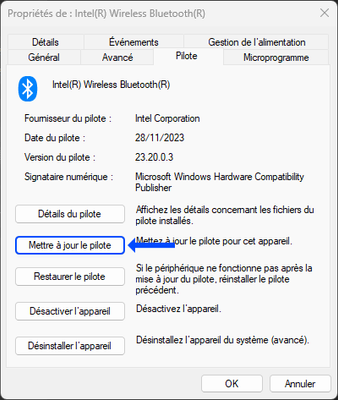

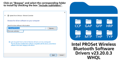

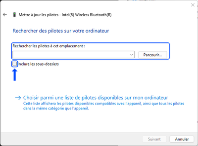

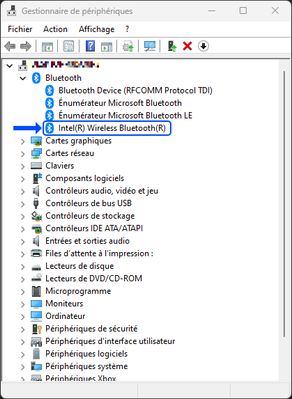

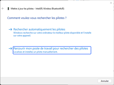

I found the solution by manually installing the drivers via Device Manager.
Freddy4
20,562 Views
It's work for me, thanks you.
Avoid setup program and use "Device Manager" for

Yes, that worked for me. Thanks. And thanks for Guaro who provided the zip file.

Snowzeron
20,403 Views
I downloaded the zip but Which folder do I install from.There's: JRP,GAP,GTP,CCP and so on so I don't know what the short words supposed to mean.
