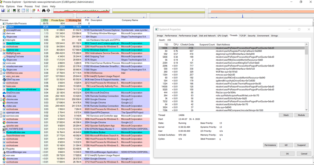

The high cpu situation happened just now, but no crash happened. Shall I close this topic and start a new one with the high CPU usage?
Hopefully my drivers are now OK. I ran the SSU utility again, so you can check. The output of the SSU is attached.
I captured two screenshots of ProcessExplorer, so you can see the weird CPU behaviour - please see below (I just can attach one file - so I inserted them below as images, hopefully you can see them ok).
One core spinning in the kernel - ThreadID 14696[=0x3968]. The first screenshot when I spotted the high CPU, and the second after cca 15mins.
I have also a new dump of the incident and there is the Netwbw02 driver on top of the stack: [built on Oct 9 18:00:54 2016].
If you need any other feel free to contact me.

Upon checking the information I can see that the high CPU usage is being caused by system, this is more related to the operating system (Corruption in libraries, registries), in some case cases malware.
It would be good to check with the system manufacturer to see if there is a way to perform a clean OS installation and check the behavior.

You can see that the thread spinning in the System process - TID = 14696 with 25% of cpu - circled in red.
In WinDBG of the dump I created you can see that the thread with ID=14696 is spinning in the NETwbw02 module.

1. It definitely occurs only when I use Wireless Card. When I am connected using the TP cable, everything is ok.
2. It might be somehow combined with the Win10 Mobile Hotspot feature, but this is just a "wild" guess. I started to use it more often in April. I've never used it before.
3. You can see in previous images (showing Process Explorer) that the next CPU intensive task is Process Explorer (taking about 9% of cpu.)
But that's ok I ran the Process Explorer to find the high cpu usage. All processes (left in the image) and threads in the System process (right in the image) are sorted by cpu usage.
There is only one thread in the System process that takes 24.83% of cpu - the next one is just at 0.76%.

I attached the zipped EventLog of the day when the high cpu state happened.
I am not sure what time zone you are in. In my time zone (UTC+2) there are logs with time 30.4.2020 14:44:34 and 14:17:32.
In this time there was the high cpu state.
At 15:04:53 I manually initiated Kernel Bugcheck - to get the kernel dump and further investigate the issue.

It happens irregularly, but it seems that it happens with Mobile HotSpot on, but it haven't occured for 3 days, so it is difficult to diagnose.
Any of those crashes occurred during the weekends, when I use the computer without Mobile Hotspot.
There is usually just one device connected. (max. 2).
