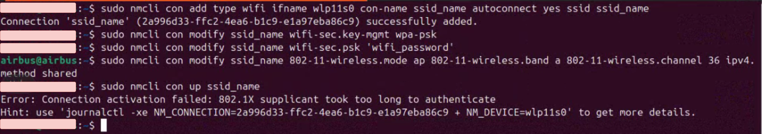

We are creating 2.4GHz and 5GHz hotspots on Ubuntu 24.10 using the Intel AX210-PCIe Wi-Fi card. While the 2.4GHz hotspot works as expected, we are unable to create the 5GHz hotspot and encounter the following error when attempting to do so:
Error: Connection activation failed: 802.1X supplicant took too long to authenticate.
Hint: Use 'journalctl -xe NM_CONNECTION=b8abc296-fc84-44c7-8d6b-f066ec551e1a + NM_DEVICE=wlp11s0' to get more details.

Swarna_123
2,319 Views
Hi @JedG_Intel
Please find below the details as requested:
1. What is the full model of your router?
---> Intel AX210 Wi-Fi 6E (802.11ax) AX210/AX1675 2x2 [Typhoon Peak].
We are validating the hotspot functionality on the Intel AX210.
2. Were you able to create a 5Ghz hotspot previously?
--->No, we were not able to create a 5 GHz hotspot previously.
3. Is this the original adapter that came pre-installed in your system, or have you changed/installed a new adapter recently?
--->Yes, this is the original adapter that came pre-installed in the system. We have not installed a new adapter recently.
4. Screenshot/photo of the error message?
--->Yes, please check the attached screenshot.
5. Is this a laptop or desktop system?
--->This is a desktop system running Ubuntu 24.04.
