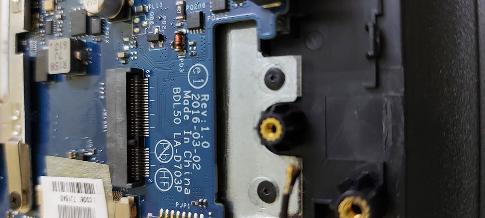

That's a 5th gen system. Are you sure it has M.2 connector for wireless? Take a picture of the current wireless card and post it here.

No, that is not necessarily correct. Please open back of laptop and take picture of card and socket.

Last opened three laptops possibility of false recognition which one of them has the same let me check this one but have no time right now sure back soon

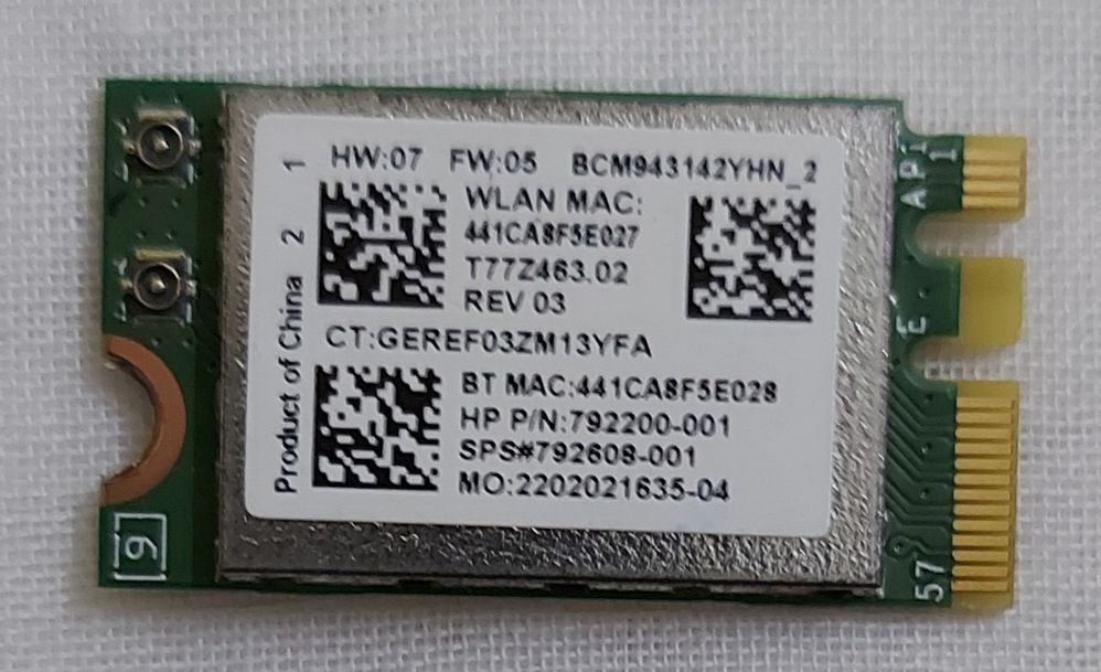

Card attachedCard attachedMy laptop slots HFMy laptop slots HFAttached card upperAttached card upperLowerLower

Well, that is definitely a M.2 Type E card (though I have never seen a hybrid board connector like that). Earlier in the conversation, I listed the M.2 Type E cards available from Intel that meet your BT 5.x criteria. Whether you can actually use any of these cards is something that you will need to determine. Many manufacturers pull slimy moves like building permit/deny lists into their BIOS in order to force people to purchase their upgrades through them. I don't know if this is the case with these products; you'll need to ask HP.
