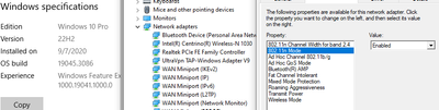

Intel® Centrino® Wireless-N 1030 DOES work on Windows*10. I am running 10 and have this adapter.  The only reason I am here is because it wont see my  5G network, only the 2.4... The link below shows other users who solved this problem. It's been 5 years or so since I got my 1030 working on Win 10 so I dont rember how I did it.
I am about to do a factory reset and want to save the actual driver download to my hard drive so I can do a search for it. If anyone can assist me with that it would be greatly appreciated. If the driver file that was installed to my windows directory is suitable I will copy that to backup but I dont know where it is.
The drivers that work are:
Version = 15.4.1.1 Date 23-1-2013
and
15.11.0.9 date unknown
Well, would not let me embed the link, but it comes from this community. The end of the page ends with m-p/307474#M5570

According to my records, the final sets of packages released by Intel that included support for the Centrino Wireless-N 1030 card were: Wireless 18.40.4 and Bluetooth 3.1.1311. Support for Windows 10 was NOT listed as provided for this card.
Now, there are a few things I can suggest:
  1. The full 18.40.4 package set DID include support for Windows 10. Unfortunately, while I saved the package set in my archive, I stupidly forgot to (also) save the release notes file (Doh!). I thus cannot verify whether or not the Windows 10 packages supported this adapter. I can provide OneDrive download link if you would like to try anyway (it's too big to upload here). Note that, after all is said and done, we could find that the version of the driver included in these packages for the 1030 is (still) 15.11.0.9.
  2. I did find a site (DriverScape) that has the 15.11.0.9 packages (date was 04-30-2015, BTW). I do not typically trust these driver download sites (many are homes to malware of all sorts), but you can do so it you are not as paranoid as I. I would point out that there are multiple driver download sites that offer these packages.
  3. I also had a hit in the Microsoft Update catalog (Here). It shows as having version 15.11.0.7, dated 01-26-2014.

Thanks, found a few packages on DriverScape and Microsoft Update catalog. Should have it covered. I found the 18.40.4 package at Softpedia but it doesnt support the 1030. Never used that site before...
Thanks for the help!

Just to be clear, you actually tried the 18.40.4 package and it didn't work? Or did you just look at the list of adapters Softpedia said it supported and stop there?
mhunter64
7,204 Views
I just looked at the list. And now that I think about, I believe I had the 1030 working under Win 8, and the free upgrade to 10 handled the driver issue...
