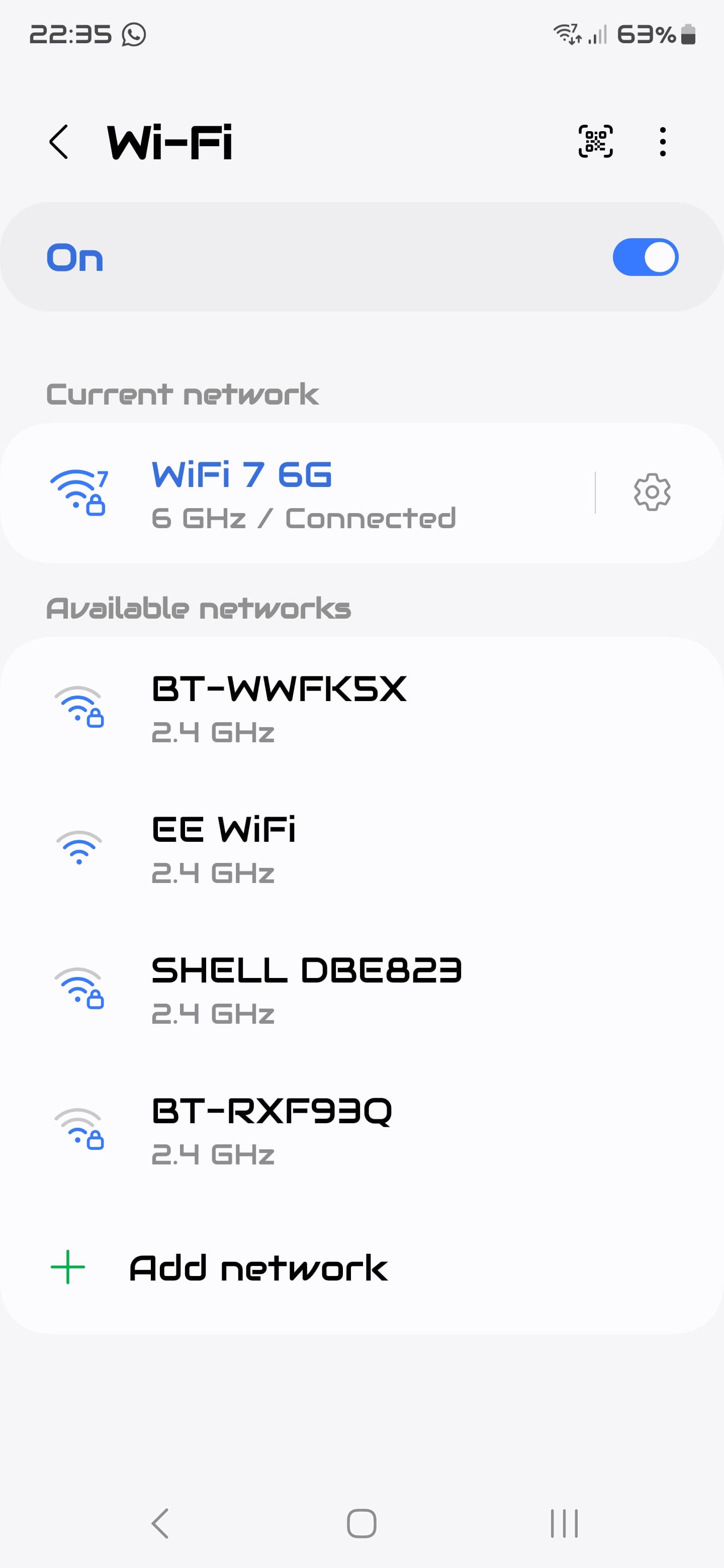

General_Internet
3,389 Views
Intel has all their SH!T sorted  they don't have fault..  Microsoft dev team needs to speak with Samsung mobile dept dev team..
I have now WiFi 7 router and everything working flawlessly.. Connected to Intel BE200 and Samsung 24 ultra as well
