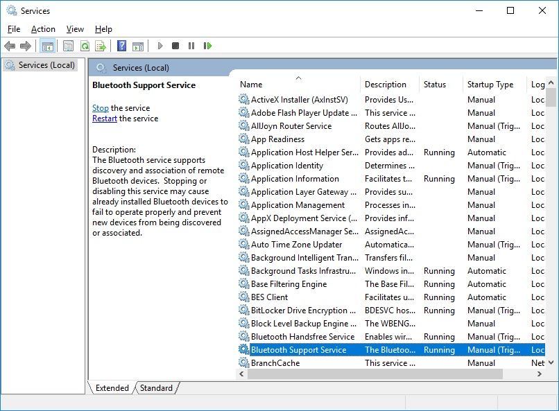

We can try the following steps now:
-Go to the search Windows search bar
-Type services
-Click Yes at the pop-up window to allow this app to make changes
-Locate the Bluetooth Support Service and click on
-Click Restart at the left top corner
