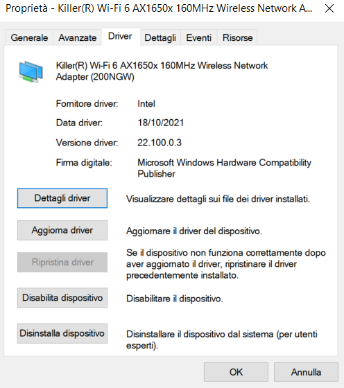

hi, i have a dell g15 laptop with Windows 10(21H2) and i often connect it to my iphone 7(intel modem)  's hotspot. Problems started when i updated my phone to ios 15 because every time i connect to the hotspot it works great,until the connection drops randomly. The problem is that it drops really often and it's annoying.
To fix this problem i tried to reinstall ios 15 (now 15.3.1), reinstall intel drivers( with and without killer suite), reset network preferences in win10, update the bios to the latest version. nothing solved.
I tried to connect other computers(with realtek adapter) to the hotspot and they don't encounter any disconnection.
The wifi card work fine with the broadband modem so i was wondering if this issue is caused by some power saving feature that i can't find.
