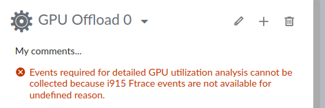

I am trying to get detailed information of the integrated GPU and have followed the steps to create custom kernel for the i915 driver config so that the low_level_ftraces would be enabled.
However, after having done so when installing intel_graphics_runtime the following error shows up on the vtune application. Can anyone help me to fix this? I have tried different approaches to install drivers and stuff but they wont help.
Error:
Events required for detailed GPU utilization analysis cannot be collected because i915 Ftrace events are not available for undefined reason.

Dear Diya,
Thank you for your early reply. I have used the documentation you have provided to configure the kernel to get i915 profiling data and it fixes the problem.
However after installing intel-graphics-compiler and OpenCl drivers to use Intel's Openvino toolkit then the mentioned problem rises again even with the configured kernel.
I will try the self-checker to see if everything is set properly after I have installed the other tools if  the problems is still not fixed I will connect back.
Thank you again for your time.

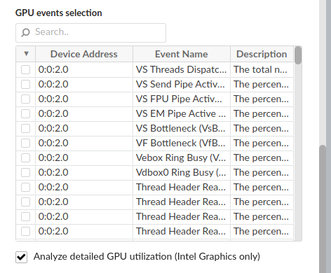

Dear Diya,
I will try the workaround and if the issue persists will let you know about it.  Meanwhile these are the information you have requested.
Vtune 2023.2.0
Followed the steps for installing there was in the Intel oneAPI Toolkit installation guide (and for clarification these issues started to exist as I have mentioned in the first post when installing intel_graphics_runtime to use it for openvino application)
ubuntu 22.04.2 LTS
11th Gen Intel Core i7-11700k 3.60 GHz
5.19.0-46-generic
This is the problem that occurs in Screenshot from 2023-07-28 15-33-50.png when trying to get the information in Screenshot from 2023-07-28 15-34-05.png.
result directory is in my /home/user/results/
Thank you very much for your time and help.
