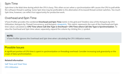

I am familiarizing myself with VTune trying to reduce OpenMP overhead for my application. (if possible)
In part of the documentation here I could read the below resolution to reduce spin time and overhead time.
A significant portion of CPU time is spent in synchronization or threading overhead. Consider increasing task granularity or the scope of data synchronization.
I just don't understand what "increasing task granularity or the scope of data synchronization." means here.
I would appreciate any further clarifications for that matter.

What that means (suggests) is you appear to have sub-partitioned the work into too small of code sections for task dispatch. IOW consider increasing the amount of work each task performs.
Excessive spin time can be cause by: unbalanced work, too little work for parallel region/task, high arbitration for critical/atomic section.

I would also interpret it as "consider increasing task granularity in the case of scheduler overhead or decrease the scope of data synchronization to avoid thread contention leading to spinning (active waits)". But of course it sounds a bit general. Can recommend to look at VTune Cookbook article to see some hints in action.
BTW - spinning in OpenMP worker threads also can be a result of waiting on serial code execution in the master thread. There is also a cookbook article on this.

Answer: The spin-wait time is measured as an overhead and is listed as part of OpenMP overhead. It is not the time spend in doing meaningful tasks but simply an overhead from OpenMP runtime. Large spin time could also results from load imbalance between threads.
>> VTune Profiler classifies the stack layers into user, system, and overhead layers and attributes the CPU time spent in system functions called by overhead functions to the overhead functions.
I can't follow what overhead functions are?
Answer:  If the OpenMP runtime makes a system call, the time spent in the system call is also accounted as OpenMP overhead.
>> Can we say overhead time is the amount of time take by OpenMP runtime to initialize a parallel region?
Answer: The overhead time includes everything from creating OpenMP threads, time taken to split the workload between threads , the synchronization between threads and the thread scheduling. Basically it includes initialize a parallel region and many other things as mentioned.
