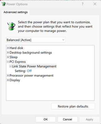

In my case (NUC 13), slow download speeds were solved by turning "Link State Power Management" to "Off" (alternatively it can be disabled also in BIOS/UEFI - search for ASPM).
