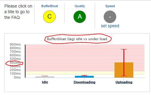

You can use this site to check your bufferbloat. Thats what causes the connection drop when my upload is not capped. You need A or A+ Quality.

Thanks for the info. Just ran the test as shown below. I'm on Shaw Cable: 600Mbps download / 20Mbps upload. I haven't cap'd upload speeds. Should I still even though it's already showing A+ results? I've already tried NVM 1.45 + LAN driver 1.0.1.4 (that's what I currently have installed)
