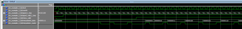

I'm trying to simulate a CIC interpolator. I noticed that when the number of stages is a power of 2 (1,2,4 or 8, since the maximum is 12), I only get zeroes as the output. Any other value for the number of stages is fine. Here are screenshots of my IP configuration:
And here is one of my simulation. The signal_I_tmp is what I feed to the interpolator. It is an 8-bit signed which increments by one at each clock. Then, the interp_valid is the out_valid of the IP and it stays low.
If I only change the number of stages to 3 and choose "rounding up" instead of "none" as the output rounding method, it works:
So would any of you know why the powers of 2 don't work?

Hi Carl, As I understand it, you seems to observe no output issue when trying to simulate the CIC interpolator with number of stages = power of 2. Would you mind to share with me a simple test design together with steps to perform the simulation? I would like to perform replication on my side to facilitate further debugging. Thank you very much.

Sorry for the delay. I have been performing a number of tests on my side. I observe that with default configuration of the CIC Interpolator (stage = 12, rate change = 8, rounding = none), there is no issue with the simulation output using IP generated example design in Q18.1Pro. As I cross check with your Interpolator.qsys, I notice that the number of stage is set to 1 in your configuration. As I tested setting stage = 1 and run the IP generate example design, I can observe output data and valid = 0. Based on these observation, we can narrow down to the parameter "Number of stages" set in your failing case. Would you mind to increase this parameter to 12 to see if it helps on your side?

thanks for your update. For your information, I am able to replicate the observation when using number of stages = 4 and 8, the output stuck at 0. There is no issue when I use 3,5 and 7. I have filed a case to Engineering on this to seek for further clarification. I will update you on the progress by mid of next week or as soon as there is any valid response. Please ping me if you do not hear back from me. Thank you.
