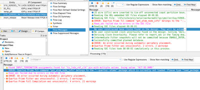

Hi
I get error messge in the plan process (attached)
Can you advice how can I fix it ?
Yishay
Error(332000): ERROR: Quartus Prime Tcl command "get_atom_node_info" belongs to the "::quartus::atoms" package which is currently not loaded. Please type "load_package atoms" to load the package before using this command.
while executing
"get_atom_node_info -key TYPE -node $cell_id"
(procedure "altera_iosubsystem_node_is_type" line 12)
invoked from within
"altera_iosubsystem_node_is_type $node $atom_type"
(procedure "altera_iosubsystem_search_back_from_node_to_atom" line 3)
invoked from within
"altera_iosubsystem_search_back_from_node_to_atom $node $atom_type $search_iter"
(procedure "altera_iosubsystem_get_atom_by_lvds_input" line 9)
invoked from within
"altera_iosubsystem_get_atom_by_lvds_input $lvds_core_instance_name $is_tx_outclock $atom_type $search_iter "fclk""
(procedure "altera_iosubsystem_get_iopll_atom" line 5)
invoked from within
"altera_iosubsystem_get_iopll_atom $lvds_core_instance_name $lvds_search_mode "
("foreach" body line 12)
invoked from within
"foreach lvds_instance_name $lvds_instance_name_list {

Can you describe what you were doing to get this error?  Is it repeatable?

So you're trying to (re)generate the IP in the IP Parameter Editor?  Need to be more specific of exactly what you are doing and when the error occurs.
Can you show a screenshot?  Are there any errors in the messages at the bottom of the IP Parameter Editor before you generate the IP, possibly indicating that you have incompatible parameters selected?
Can you try creating a brand new instance of the IP to see if the error still occurs?
And what is your Quartus version and target device?
Lots of basic info needed here to figure out what's going on.

Hi
The error occure in the middle of plan stage
Attach screenshot :
Quartos version 20.3
My target device :
I have the LVDS SERDES IP in my project -My change was  defintion in the IP GUI to   get clock from external PLL instead of internal PLL
There are no errors/warnings in the GUI editor when I try to regenerae
Attached screenshot :

Wired ,
I generate new IP  - like the older ( same parameters ) but new one
Then , I replaced the instance in my project and everything was good - I succseed to generate FPGA sof file
I didn't understand  the problem because the Quartos error message was not clear

The issue is the order of the .ip files. The pll.ip needs to be before the lvds_serdes.ip in the qsf file.
See https://www.intel.com/content/dam/www/programmable/us/en/pdfs/literature/hb/stratix-10/ug-s10-lvds.pdf#page=53
