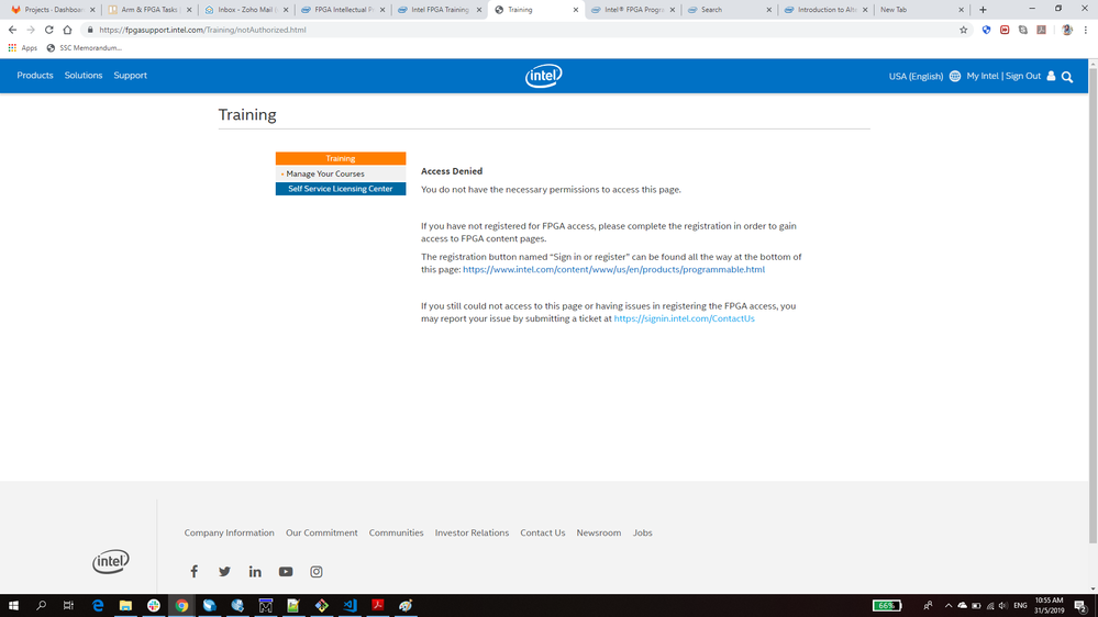

Could not able to watch the videos even though they are free from the above link mentioned for training. Recently we have purchased the license also still permission denied is coming. The issue also raised with intel and screenshot is attached please look into it and solve for us then our development will not stop because of this.

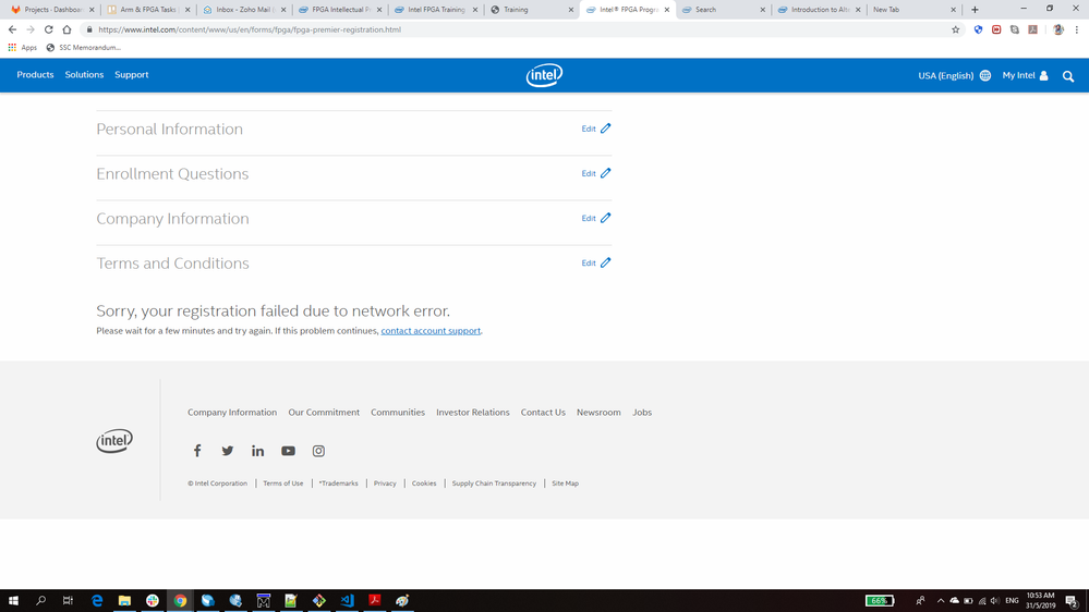

VenkateshSathar
1,723 Views
The attached errorimage.png is coming to watch videos. Then when I go for premier account registration the following error is coming. I hope you guys solve this for me soon. Because I bought license but I couldn't able to see videos or generate license.dat file also because of these issues from your website management side. This if making my work sick. Please address this ASAP as a priority. I have trying to highlight this from past two weeks.
