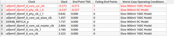

Do you have an idea where this behavior could be coming from ? Indeed I have timing issue :
But I'm not really comfortable with timing constraints ! If you need more information, don't hesitate. If this can be relevant, here is also the amm host parameters of my custom component amm controller in the component editor :

Try to solve the timing issue first, it can impact the memory functionality.
Check the DDR Report for the summary of the memory timing.
Also check for the path the timing is not meet. from which modules to which.
I expect this timing may occur in core timing path.

For Timing errors, I don't have any setup error, but I have 4 hold errors for instance with this path :
-0.346 u0|emif_0|emif_0|arch|arch_inst|io_tiles_wrap_inst|io_tiles_inst|tile_gen[0].tile_ctrl_inst|pa_core_clk_out[0] auto_fab_0|alt_sld_fab_0|alt_sld_fab_0|auto_signaltap_auto_signaltap_0|sld_signaltap_inst|acq_data_in_reg[102] u0|emif_0|emif_0_core_usr_clk u0|emif_0|emif_0_core_usr_clk 0.000 3.609 3.688 Slow 900mV 0C Model
Also I have 1 single timing error in the "Report DDR" of the timing analyser, for all 4 models (slow/fast/0C/100C), which is on the "Read Capture" signal of EMIF :
Actually the design works but I don't know what to do with these errors, do you believe it is relevant to fix them ? Maybe this is only due to signaltap logic.

Yes, remove Signal Tap and see if you are still having timing issues.

Sorry for late response, in fact I could resolve the timing issue while keeping signaltap, this was due to the trigger clock which was set to "DDR4A_REF_CLK" (reference clock input for EMIF) instead of the emif_usr_clk of EMIF. Since these have both the same frequency, I have troubles understanding why using the dedicated ref clk in signaltap generated timing errors ? If you have any insight about this, you're welcome.
