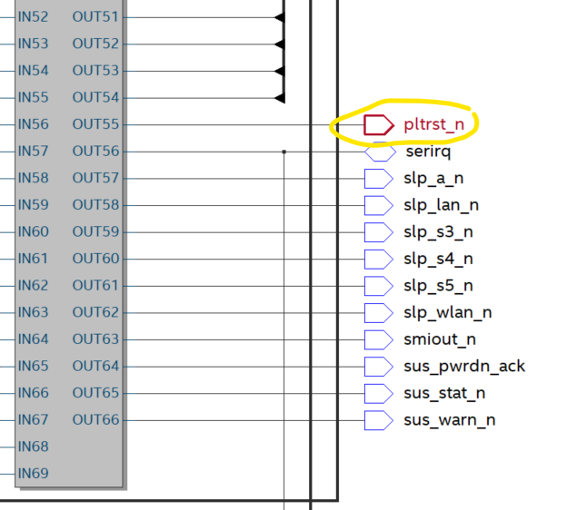

Feedback from Engineering, we have tested with MAX10 and Arria 10. Both can see the pltreset_n virtual wire at the output port.
MAX10 we tried on Quartus 18.1.
Arria 10 we tried on Quartus 22.3.
When generating the IP, you need to select virtual wire channel or all chanels like below:
below is the screen shot from virtual wire index table, taken from Embedded peripheral IP userguide, eSPI chapter. The direction is Host to Agent(output). The peripheral channel allows you to communicate between the eSPI host and the
eSPI endpoints located at the agent side (example: PORT80). To reset the channel, use the platform reset (PLTRST_n Virtual Wire).
After compilation, you will see the "pltrst_n" output port from eSPI LPC bridge IP.
Below is RTL viewer for Arria 10:
and below is RTL viewer for MAX10:

WFitt
2,173 Views
Hi Farabi,
thank you for your response.
Unfortunately your answer is relating to eSPI LPC Bridge. We are using eSPI Agent Core. A pltrst_n port is not existing at this.
Wolfram
Farabi
2,152 Views
Hello Wolfram,
Feedback from engineering: they are aware of this issue.
Fix plan : the lptrst_n virtual wire port will be available in next Quartus release.

Farabi
2,069 Views
Engineering suggested if you can use the espi_reset_n port available in the current IP which having same function as RESET# port of eSPI agent IP.
