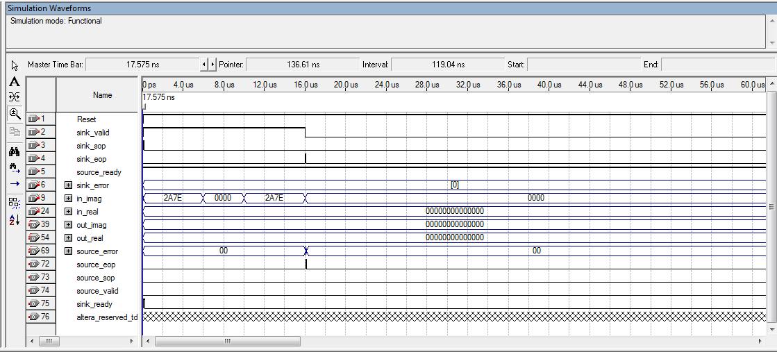

Hi everyone,
i face a strange problem with megacore fft.
The operation mode i used is
burst mode, Quad output, 1024 points, 2 engines
and the device is Cyclone II
Quartus II v80sp1
i have do a lots of testing for the fft megacore...
first, i would like to read data from fifos which also the megacore produce from the wizard to be the fft inputs (include the real part and image part).
i write control module (in Verilog) to handle the control signals between fifos and fft.
in my design, the fft only accept one frame(1024 data samples) one time, so i need to use burst mode. i read user guide of FFT Megacore Function and understand that there is a small fifo buffer at the sink of the block.
i write finite state machine to control sink_sop, sink_eop, sink_valid carefully, and watch the simulation result.
it goes wrong!
when the sink_ready is asserted, i asserted rdreq(fifo read enable signal) to read data from fifo, and then asserted sink_valid.
sink_sop asserted only at the first data, sink_eop asserted only at the last data, and sink_valid asserted from sink_sop to sink_eop.
there is no any source_error occurs in the process, but the source_real and source_image are wrong. :((the source_sop, source_eop and source_valid are OK, source_ready is asserted) <= the source_real and source_image come out, but the value is incorrect.
more information i got, when i remove fifos and control module. only the fft megacore, and input the sink data from simulation(Vector waveform file). it works correctly!!! Why?:confused:
anyone can do me a favor, please~
ps. attach files are the simulation results

Hi taylor,
Can you tell me the clock you're using??

Hello again,
i'm having some problems with FFT megacore, because source_sop is never asserted and sink_ready is asserted just for a few clock's and then comes to low.
i'm using a 30ns clock.
I attach my simulator waveforms.
