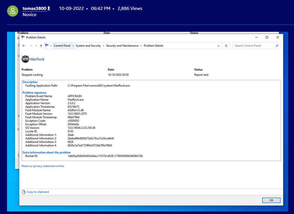

I installed the game on a new computer ( 12gen i5-1240p ) with built-in graphics and the problem repeated itself.
When I take a weapon, the game crashes.
Intel please fix your driver.
We bought your product and it doesn't work.

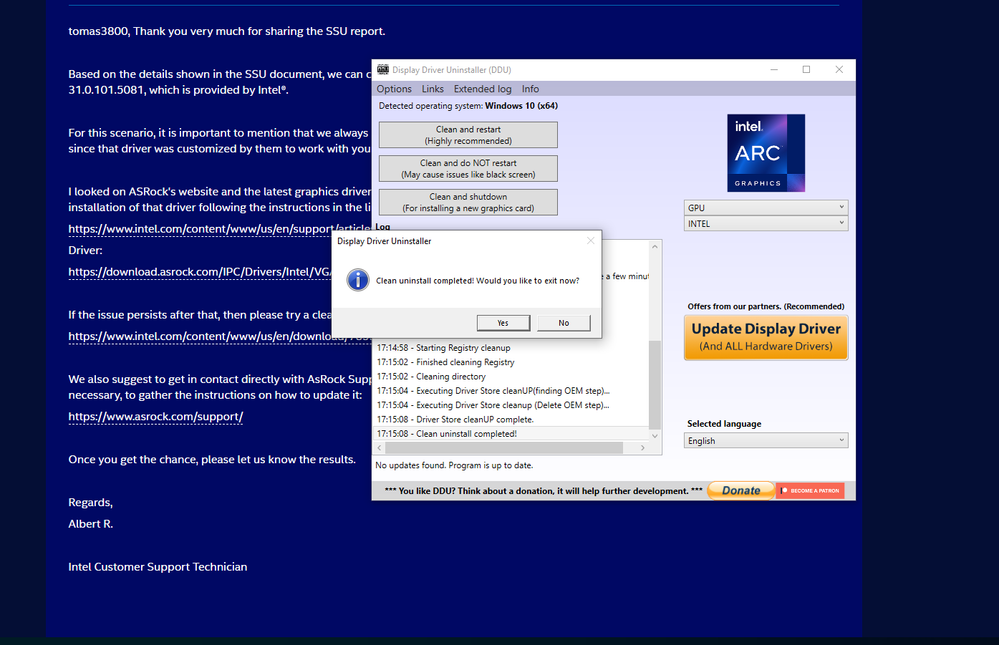

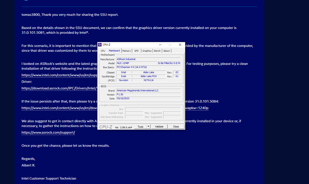

tomas3800, Thank you very much for sharing the SSU report.
Based on the details shown in the SSU document, we can confirm that the graphics driver version currently installed on your computer is 31.0.101.5081, which is provided by Intel®.
For this scenario, it is important to mention that we always recommend to install the graphics driver provided by the manufacturer of the computer, since that driver was customized by them to work with your specific platform.
I looked on ASRock's website and the latest graphics driver version they have available is 31.0.101.3729. For testing purposes, please try a clean installation of that driver following the instructions in the links below:
Driver:
https://download.asrock.com/IPC/Drivers/Intel/VGA/VGA(v31.0.101.3729).zip
If the issue persists after that, then please try a clean installation this time of our latest graphics driver version 31.0.101.5084:
We also suggest to get in contact directly with AsRock Support to make sure the latest BIOS version is currently installed in your device or, if necessary, to gather the instructions on how to update it:
https://www.asrock.com/support/
Once you get the chance, please let us know the results.

I did everything you asked.
I even disabled e-cores. Please watch the video. When I take a weapon, the game crashes.

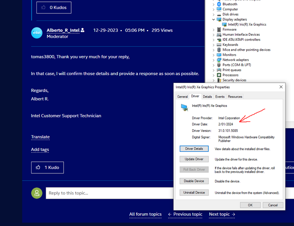

tomas3800, Thank you very much for your reply,
In that case, I will confirm those details and provide a response as soon as possible.

I was waiting for a new intel driver to fix the problem.
But Intel did not want to solve the problem with the driver.
Why produce integrated graphics if there is no one to write the driver?
Will I get the same problem in the 14th generation igpu Intel processors?

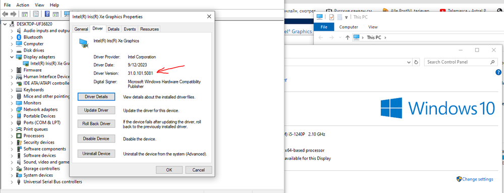

Having the same issue with the Intel Iris Xe Graphics.. When will a fix be implemented?
