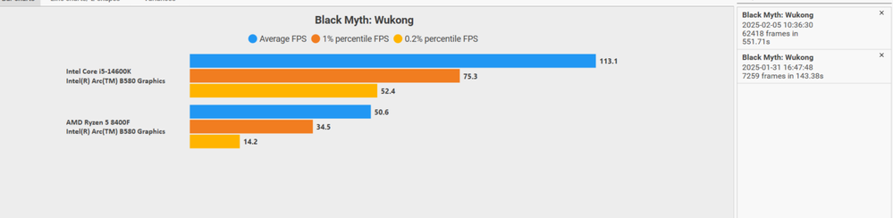

Thanks for responsing so fast, I also work it at driver version: 32.0.101.6557_101.6262 (Latest) agian.
1.1920*1080p today
2.2560*1440p today
3.2560*1440p at 31,January
Obviously,there is a clear improvement here.
I think I should update CPU to the same level of 14600K to obtain better gaming experience.
Thanks!

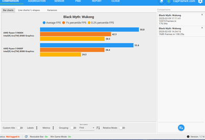

Are you still at here?After last communication,I update my cpu to 9600X which is the same level of 14600K,
and I try it again.But there is no increasing at all in same settings with the 32.0.101.6557_101.6262 (Latest)
So Is there a problem with the compatibility of AMD CPU and B580? Can it be optimized?

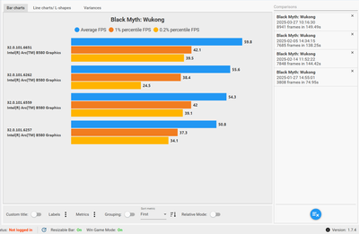

Right, it works much better in 6651WHQL.And I have stage cleared too.
- Marcar como novo
- Marcador
- Subscrever
- Silenciar
- Subscrever fonte RSS
- Destacar
- Imprimir
All right,after 2025.4.19,the game has xess2.Everthing goes rightly.It's a surprise.
