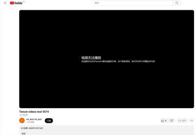

Jean_Intel
7,768 Views
Hello Zallureeee,
We would like to let you know that after testing the issue internally, we have been unable to replicate the problem you described. We tested this with the latest driver 31.0.101.5074, and did not notice any issue, in fullscreen mode the videos played without problem, and you can take a look at our video showing the issue replication. We recommend using How to Use the Display Driver Uninstaller (DDU) with our latest drivers and make sure the browser is up-to-date.
Best regards
Jean O.
ZAllureeee
7,756 Views
Hi Jean,
First, thanks to the Intel Graphics Team for taking the issues I raised seriously.
Second, I‘m always on the lookout for driver updates for Arc A770, so I have updated the driver to 5074 at the first moment. But the issue is not be solved.
The video that you uploaded on the YouTube has be blocked because of copyright reasons,  so I cannot watch it. But its ok, I trust you have tested this issue.
So based on your test, I believe maybe the issue comes from Software Compatibility Problem between Arc Graphic Driver and other software on my computer. And its not easy for you to locate it obviously.
So I think it's time to finish this Discussion. I will watch Tencent Video with other browser or desktop client. Maybe it will be normal when I reinstall my system lol🤣.
Finally, thanks to you and the Intel Graphic Team for your constant follow up on my questions during this time. I sincerely wish Intel Graphics get better and better in the future! Hats off to your work ethic of respecting the demands of users!
Jean_Intel
7,736 Views
Hello Zallureeee,
We are sorry to hear that your video has been blocked due to copyright issues. Unfortunately, we may not be able to upload the video to YouTube as it may continue to trigger copyright claims. However, we will try to attach the video to this post.
We have recently released a new driver update that you can test to see if it resolves the issue. However, since we couldn't reproduce the issue on our end, it appears that the problem is not related to the graphics driver. Therefore, we recommend that you contact the app developer for further assistance with your issue.
Lastly, we appreciate your feedback. Thank you for reporting your issue!
