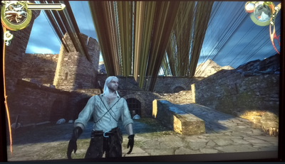

Hi, my setup is:
- Alder Lake S Core i7 12700K - Stepping C0
- MSI PRO z690 A DDR4
- DDR4 16GB (2x8GB) 3200 16CL - 2xKingston KF3200C16D4/8GX
- Windows 11 Evaluation Edition (to try it out)
- GPU Drivers: 30.0.101.1191 (tried all previous versions also)
I'm observing a weird artifacts (see photo attached) when playing in The Witcher Enhanced Edition (first from trilogy).
There are no problems with other games and benchmarks I executed on this setup (World Of Tanks with all settings also unplayable Ultra, Civilization 4, Unigine Sanctuary/Heaven/Tropics/Valley/Superposition, FurMark1.29). I tortured this setup in all possible ways like Intel Validation Engineer should do and it is solid rock stable also with GPU overclocked.
But the artifacts are only in this one game and are reproducing regardless of my BIOS settings - even with Optimized Defaults with XMP profiles disabled. In my opinion this may be a bug in the driver. I have the second PC with Core i5 2500k and GTX970 and never seen such artifacts. Also plugged in GTX970 to this Alder Lake setup there are no artifacts visible.
Please ask validation fellows from graphics team to try reproduce this and hopefully fix the problem.
Here is the link video made by Smartphone Camera from The Witcher with artifacts gameplay:
https://drive.google.com/file/d/1-0yshzG8duT2Xm4wmx0hdpIUWxuo6zf1/view?usp=sharing

Hi Sławek,
After troubleshooting this issue, we found the root cause to be on one of Microsoft’s APIs. Basically, Alder Lake (and all Intel CPUs/GPUs onwards) are dropping support for the DirectX 9 API (20-year-old now). So, to address people wanting to play older games only supporting this API, Microsoft created the D3D9on12 translation layer, which basically redirects all DirectX 9 calls to DirectX 12. And for your specific issue on The Witcher Enhanced Edition, the root cause was determined to be a bug on this D3D9on12 translation layer from Microsoft.
We reached out to Microsoft, and they worked and fixed the issue. However, it now falls to Microsoft on when they will roll out the new version of D3D9on12 with the fix. We expect it to be included in the upcoming Windows 11 22H2, but since we don’t control Microsoft’s release schedule, we cannot ensure it.
Since the fix for this issue now depends on a company other than Intel, please let me know if we can close this case.

In this case, we would like to let you know that we were able to reproduce the issue and it has been reported to our driver development team under BUG ID 14016136684.
This fix might take from 3-6 months due to the current workload, we cannot promise any specific date. Please let us know if we can close this thread.
