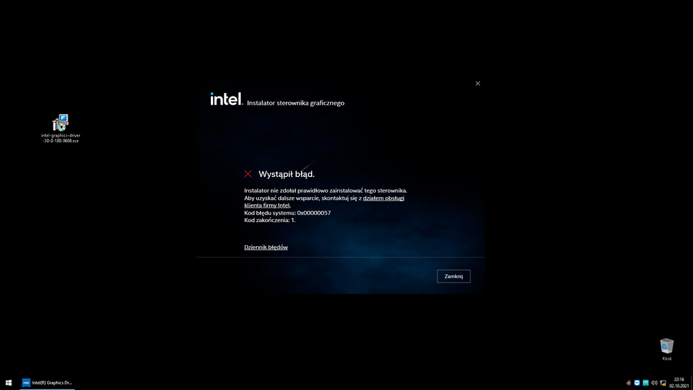

Hello, As in the topic,
it is not possible to install a graphics panel in UHD630
error code: 0x00000057
I changed the set from:
ASRock Z390 Extreme4 + Core i7-8700K
on
MSI Z490 A-PRO + Core i7-10700K
AlHill
2,246 Views
Did you simply move the boot disk from ASRock to MSI?
If so, do a clean install.
[Windows 11 is the new Vista]
MuTi
2,233 Views
Ok I see...
I still have a question, is it possible to install the (new panel) Intel Command center without this pathology [Microsoft Store]?
n_scott_pearson
2,185 Views
No, it is required by Microsoft to come from their store. Many manufacturers are ignoring this requirement and implementing their control panels the old way, but not Intel.
