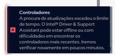

Today, after upgrading my graphics driver to 31.0.101.4672, I'm facing a wired problem. Update check on Intel Arc control is getting timed out, and its not telling me if my driver is up to date or not. What can i do to fix this issue. I added a photo of the reply I'm getting after few minutes.

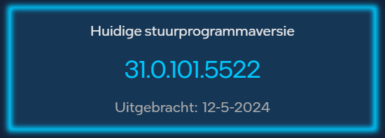

Still same problem after installing a new version... Very Ignoring 😞

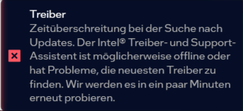

Still happening on latest version (5522):
(its the same text like OPs but in german but the problem is STILL the same after 6 months and dozens of versions)

yo i fixed it by running it as administrator it searches without giving me that error
- Tags:
- Possible Fix
i think its lame fr that this hasn't been fixed tho but thats alot easier than intel's fix
It doesn't work for me, I close Arc Control and then open it as Administrator but it gives me the same error.
What worked for me (but only temporarily) was to uninstall the Intel graphics drivers using DDU. But later when a new version of the graphics driver was released and I updated it to the new version the error came back...
darn i uninstalled arc control with a uninstaller program then i installed the latest graphics driver then started as administrator and now its working for me thats sad tho its really lame that this issue still exists
Sorry, but that did not solve my issue. I had tried Admin but still times out. Thank you for the suggestion though.
let me know if it works😀
Still not working (with 32.0.101.5972 version)
you tried opening it as administrator?
