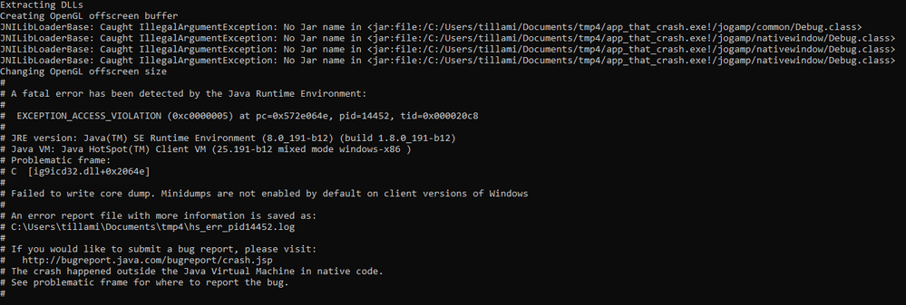

We have a Java application running at multiple customers. This application has started to crash at the customers after rollout of updated Windows 10 Intel graphics drivers for their machines.
This happens on several machines with an Intel 620/630 UHD/HD graphics card, machine manufacturers include Dell and Lenovo.
We've managed to replicate the crash in a small code snippet. Running the following JAVA code on a Windows 10 machine, in a 32-bit Java VM, makes the code crash with an access violation error in the Intel graphics driver.
import com.jogamp.nativewindow.AbstractGraphicsDevice; import com.jogamp.opengl.*;   public class Main {   public static void main(String[] args) {   AbstractGraphicsDevice device = GLProfile.getDefaultDevice(); GLProfile profile = GLProfile.getDefault(device); GLCapabilities capabilities = new GLCapabilities(profile);   GLDrawableFactory factory = GLDrawableFactory.getFactory(profile); GLOffscreenAutoDrawable m_offscreen = factory.createOffscreenAutoDrawable( device, capabilities, null, 64, 64);   m_offscreen.setSurfaceSize(64,64); } }
Part of the log:
# # A fatal error has been detected by the Java Runtime Environment: # # EXCEPTION_ACCESS_VIOLATION (0xc0000005) at pc=0x5179064e, pid=20212, tid=18440 # # JRE version: Java(TM) SE Runtime Environment (8.0_73-b02) (build 1.8.0_73-b02) # Java VM: Java HotSpot(TM) Client VM (25.73-b02 mixed mode windows-x86 ) # Problematic frame: # C [ig9icd32.dll+0x2064e] # # Failed to write core dump. Minidumps are not enabled by default on client versions of Windows # # If you would like to submit a bug report, please visit: # http://bugreport.java.com/bugreport/crash.jsp # The crash happened outside the Java Virtual Machine in native code. # See problematic frame for where to report the bug. #   --------------- T H R E A D ---------------   Current thread (0x02c3d400): JavaThread "main" [_thread_in_native, id=18440, stack(0x02c80000,0x02cd0000)]   siginfo: ExceptionCode=0xc0000005, reading address 0x00000000   Registers: EAX=0x18a49624, EBX=0x189fe168, ECX=0x99e91b0e, EDX=0x00cda218 ESP=0x02ccf37c, EBP=0x02ccf384, ESI=0x00000000, EDI=0x00000000 EIP=0x5179064e, EFLAGS=0x00010246   Top of Stack: (sp=0x02ccf37c) 0x02ccf37c: 00d60f00 00004808 02ccf390 5191f40d 0x02ccf38c: 189bf370 02ccf3e0 517c043c 00d60f00 0x02ccf39c: 99e91b9e 231db2d0 189fe168 00d60f00 0x02ccf3ac: 2398de98 2330ef01 00d60f00 2330ef48 0x02ccf3bc: ffffffff ffffffff ffffffff 00d60f00 0x02ccf3cc: 00024cf4 18a17580 02ccfa58 5201920c 0x02ccf3dc: ffffffff 02ccf3f8 517bfb87 00000000 0x02ccf3ec: 189fe168 189fe168 00000001 02ccf434   Instructions: (pc=0x5179064e) 0x5179062e: cc cc 55 8b ec 51 57 ff 15 50 41 03 52 89 45 fc 0x5179063e: b9 d8 80 2d 52 8d 45 fc 50 e8 34 8e 00 00 8b 38 0x5179064e: 83 3f 00 74 5e 56 8b 77 04 83 c6 08 56 e8 53 bb 0x5179065e: 7b 00 8b 47 04 83 c4 04 80 78 04 00 56 75 3b e8     Register to memory mapping:   EAX=0x18a49624 is an unknown value EBX=0x189fe168 is an unknown value ECX=0x99e91b0e is an unknown value EDX=0x00cda218 is an unknown value ESP=0x02ccf37c is pointing into the stack for thread: 0x02c3d400 EBP=0x02ccf384 is pointing into the stack for thread: 0x02c3d400 ESI=0x00000000 is an unknown value EDI=0x00000000 is an unknown value     Stack: [0x02c80000,0x02cd0000], sp=0x02ccf37c, free space=316k Native frames: (J=compiled Java code, j=interpreted, Vv=VM code, C=native code) C [ig9icd32.dll+0x2064e] C [ig9icd32.dll+0x1af40d] C [ig9icd32.dll+0x5043c] C [ig9icd32.dll+0x4fb87] C [ig9icd32.dll+0xf7f7] C [OpenGL32.dll+0x1f477] C [OpenGL32.dll+0x1f6da] C [jogl_desktop.dll+0x560a6] j jogamp.opengl.windows.wgl.WGL.dispatch_wglMakeCurrent0(JJJ)Z+0 j jogamp.opengl.windows.wgl.WGL.wglMakeCurrent(JJ)Z+41 j jogamp.opengl.windows.wgl.WindowsWGLContext.wglMakeContextCurrent(JJJ)Z+37
The last DCH driver version that this crash does NOT happen on are 26.20.100.6709, but all driver releases after this version seems to be affected.
When running the same code in a 64-bit JVM, this crash does not happen.
Please find attached a crash log and a zip file containing a compiled Java JAR file and all the required dependencies.

I've attached a new ZIP file with a stand alone EXE file in it, that launches the application with the required 32bit Java version.
This application will extract the DLL files needed and then run the application in the original post.
The output from this EXE file will be something like the below image. Also a hs_err_pid[proc#].log file will be created with the full errors needed for troubleshooting.

After some testings I have been able to replicate the situation you are experiencing, I am currently checking some more details to see if this is something that can be diagnosed on our side, I just wanted to keep you updated, this will take some more time so please allow me and I will get back to you as soon as possible.

I would like to inform you that this issue has been submitted as a bug to our debug team (Bug ID 14010119573). I cannot promise any particular outcome at this point but rest assured that this is in the proper hands.

Hi again Mikael,
I have received a new update from the dev team.
After retesting this issue with our latest internal driver build the issue is no longer occurring i.e. the app you provided us that crashed before works fine now (I tested it myself as well and can confirm the positive results). There was no specific code change though, so it appears another bug we fixed in this build has had a positive impact on this one.
This internal build is not included in any production driver yet, but it will be soon.
Long story short: wait for a couple of driver releases from now and this should be fixed.

10,207 Views
Hi again Ronald,
I have tested the latest Windows 10 drivers (26.20.100.7323) that was released last Friday, and it seems that the issue was resolved in that version. Our application is working with that version.
Huge thanks for all of your support with this!
