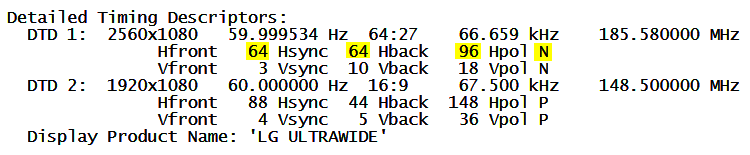

After updating the Intel® Graphics Command Center, the scaling options are no longer available. The only workaround I’ve found is installing a legacy driver (30.0.101.1340). However, removing the ability to support a widescreen monitor is a major downgrade for my laptop. Even though my system is fully capable of handling it, I can’t properly use my monitor.
I use a FLATRON 25UM58-P monitor, and my desktop mode should be 2560x1080p, 60Hz, but the active signal mode stays locked at 1920x1080, 60Hz. This severely impacts my workflow as a designer.
I’ve already tried using the Intel Graphics Software for scaling, but it didn’t work. Additionally, I have generated an SSU report, which is attached. Please let me know if any additional information is required. I look forward to your insights on resolving this issue.
For reference, I’ve previously followed this solution: Dell Community – Vostro 3500 Ultrawide 2560x1080, but Windows keeps automatically upgrading my driver, which reintroduces the issue.

In my opinion, your issue is similar to those described here and here.
The monitor reports its modes over the cable as intended. However, individual video timing is required for 2560 x 1080.
I don't think this can be solved via CRU. The graphics driver itself is responsible for this.
Your processor (i5-1035G1) is one of the 10th generation (Ice Lake). The graphics drivers for this generation and older are no longer being developed functionally.
If driver 30.0.101.1340 works for you, try the following:
  1. Install driver 1340.
  2. After restarting your computer, let Windows check for updates. It will find and install another driver.
  3. After restarting your computer again, manually install driver 1340 again without the "clean install" option.
  4. After the installation is complete and you restart, the driver 1340 should be retained.
