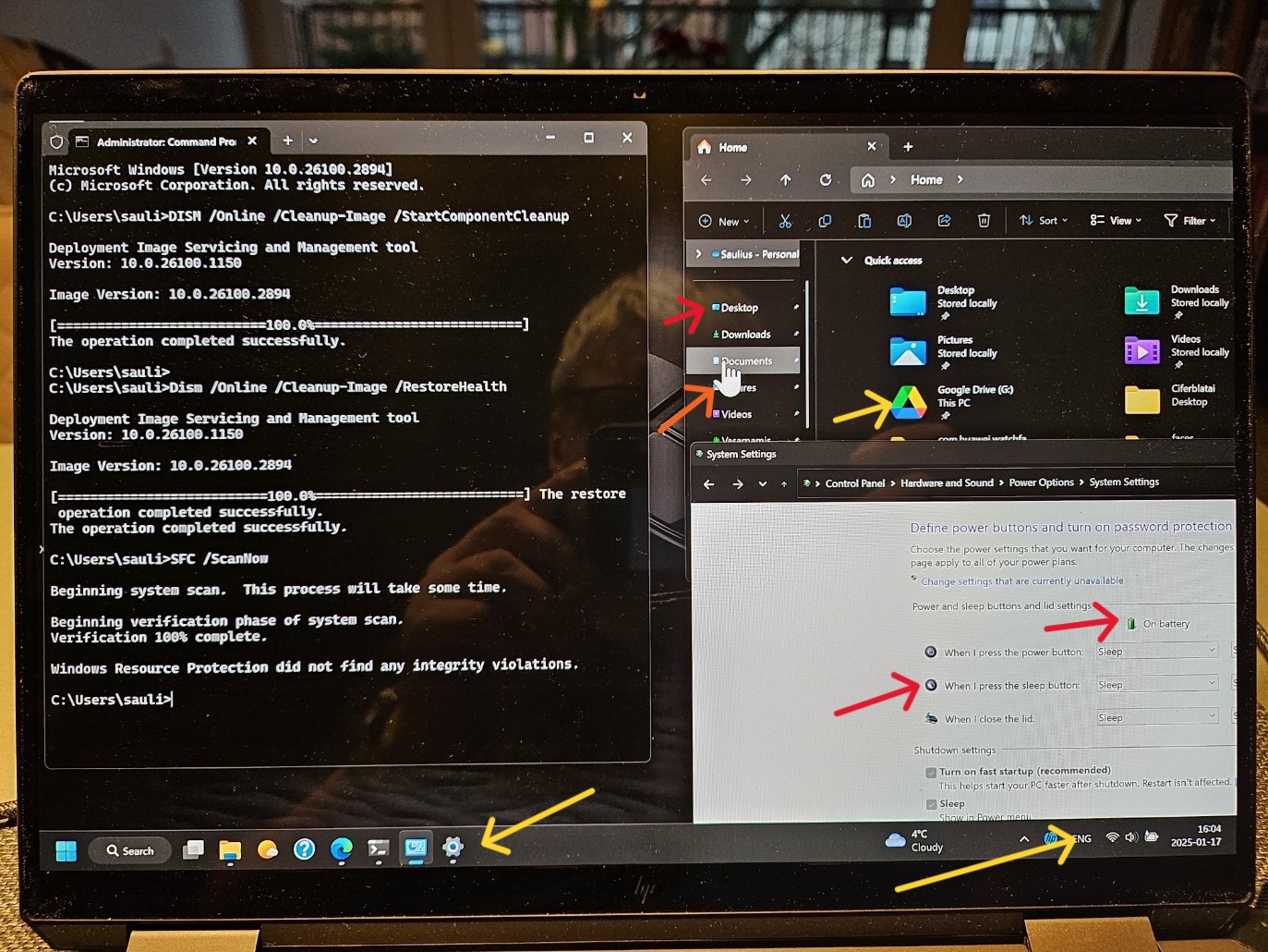

This is my experience:
Installed latest Windows Update, Latest update from HP Support Assistant, From Microsoft store, nothing helped.
Downloaded and installed Intel® Graphics Driver 32.0.101.6303, not helped.
Downloaded DDU and executed in Windows Safe mode, cleared GPU drivers. Again install Intel® Graphics Driver 32.0.101.6303 with clean install option, not helped.
DISM and SCF no errors see in (pic #1), not helped.
Try to found differences and errors in Event Viewer whet boot with Fast Startup and without.
Try use custom scaling. not helped.
Change windows theme, mouse cursor theme, mouse cursor size, lock mouse cursosr via Group Policy and Registry, not helped.
Resolve Intel WiFi 7 BE200 drivers issue, not helped for graphics issue.
Only One, Fast Startup disabling Solves the problem.
But if I need to get back issue i do next steps:
Enable Fast Startup -> Restart PC -> Shutdown PC -> Bootup PC and issue came back.
A few more of my thoughts and observations:
If I change scaling parameter in windows settings, change everything in same direction (icons sizes, text sizes, mouse cursor size)
In issue mouse cursor huge, some icons normal size, some small, text size normal.
Maybe problem is in BIOS/UEFI?
Thank You.
P.S. Pic. #2 Yellow arrows - normal size, Red arrows - small size, Orange - Huge mouse cursor.
