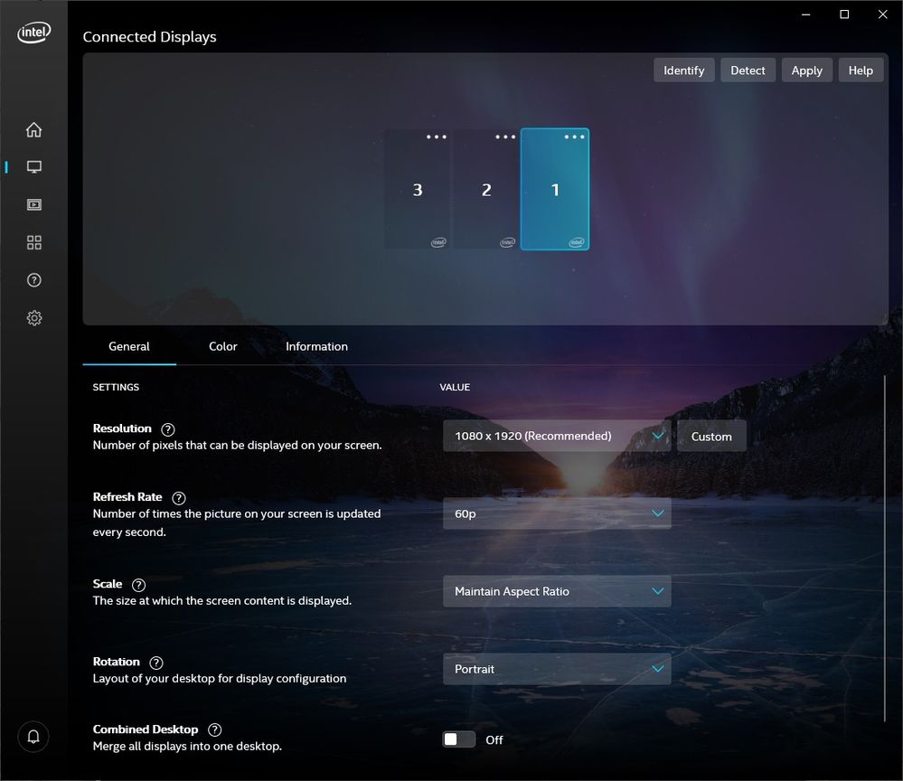

I have 3 monitors in portrait mode 3 x 1080x1920. They are arranged one after the other from left to right, so that a combined desktop would be 3240x1920.
But when I enable combined desktop from Intel Graphics Command Center, the monitor layout gets automatically re-arranged to 1080x5760 (the driver lays out the monitors one below the other, from top to bottom).
The result is a combined desktop that is no longer usable.
Is there a way for me to prevent the automatic layout and get a combined desktop with the expected layout from Windows Display Settings please ?

Your "Combined Desktop" is Off in your screenshots.
As soon as I set it to On, the monitors get re-arranged automatically, and I can no longer drag them back to the position I need, because now it shows a single monitor only.

For this set up we recommend not using adapters or video converters since this could cause handshake issues, you can try the following steps:
1. Launch the Intel® Graphics command center application and navigate to the Display page.
2. In the Top ‘Windowed’ portion of the UI there should be icons representing all displays currently plugged into the platform, one of which will be an in-built display, for example, a laptop display.
3. On combining the displays, the in-built display will be disabled, since in-built displays are not able to participate in Combined Desktop functionality. Due to this, it doesn’t matter where the inbuilt display icon resides on the user interface. For the other connected displays, arrange them horizontally and aligned relative to each other in a configuration matching their physical configuration relative to each other (i.e. if the number 2 physical display is adjacent and to the left of the number 3 physical display, move the icon for display 2 adjacent and to the left of the icon for display 3 in the user interface window). Example:
Picture 1
4. Verify the numbered user interface window display icons match their physical locations by clicking the “Identify” button in the upper right corner. This will show the identifying number of each display in its upper left-hand corner, allowing the user to match the physical display locations to their user interface window locations.
5. Once the user interface window icons are correctly arranged click the “Apply” button in the upper right of the user interface window.
6. Move the mouse pointer horizontally across the physical displays to verify their user interface configuration is the same as their physical configuration.
7. To apply the Combined Desktop mode, toggle on the “Combine Desktop” parameter located at the bottom of the parameter list with any of the displays selected. No matter which display is selected (shown by its representative icon turning blue), all active enabled displays will be combined into one large desktop, except the in-built display which will be disabled.
8. The end result should be that the you see one wide blue display icon representing the multiple displays combined to a single virtual display. The in-built display will be shown as a dark icon to the right of the blue virtual display icon representing the combined displays.

@LeoC_Intel, none of this drivel matters; the feature just doesn't work the way that it should. What a horrible, HORRIBLE implementation!
- The feature should be combining the displays as and where they appear. It is not. It is reordering the displays. In my setup, the displays physically appear in order 1, 3, 2. After combining, they are now rearranged in order 1, 2, 3 - and this reordering remains in place even after the combining feature is disabled!
- The feature should be honoring the orientation of the screens. It is not. It is rotating all displays back to Landscape orientation and jamming them end to end.
Bottom line, the feature, as implemented, services a very small percentage of the configurations possible (in fact, only 1 of the 81 possible position/orientation configurations for the 3-display case). Almost useless.

I just tried this myself and I can see the issue. This is the recording I made of my test: https://youtu.be/o3rdbIcKjTo
I agree with you, the implementation of 'Combined Desktop' needs more work. The display numbering system gets re-arranged when enabled. And it does also mess the order after it is turned Off (in my case it didn't even re-enabled my laptop's built-in display).
Just to be clear, once Combined Desktop is On this re-ordering issue should not impact functionality i.e. the displays do form a functional single screen.
Thank you for your feedback, I am forwarding this bug report to the Intel Graphics Command Center development team.
Ronald M.
Hi @n.scott.pearson
I just got a reply from the Intel Graphics Command Center development team on the displays re-arranging after disabling Combined Desktop mode.
It is confirmed to be expected behavior. You see, the Collage feature itself is a hacked up feature and not OS aware. To make collage work in Gen 9 graphics we actually have to clone/mirror all displays at OS level. The process of mirroring is easy but all collaged displays coordinate would change to x=0, y=0. This would mean that we would lose the persistence value when we want to un-collage. In the old Graphics Control Panel we solved this by just enabling a single display when coming out of collage and have users re-enable displays one at a time and reposition, but with IGCC we made a decision to re-enable all displays out of collage so users would just have to reposition only after collage.
