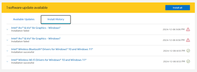

On the Driver and Support Assistant site, it seems like the GPU is detectable there, but there's no sign of it in System Information either.
Screenshot from Driver & Support AssistantScreenshot from Driver & Support Assistant
I tried to update the drivers via the Assistant, to no avail.

Eventually I was able to get my PC to see and recognize the GPU, but the problem evolved: I was unable to update the drivers. In fact, the Intel Graphics Driver Installer would extract to 100% but did not complete execution, regardless of which driver I attempted to install.
Long story short, with Evan's help (the guy from Sparkle) I had to take several measures, including:
  • Disable 'secure boot' in the BIOS
  • Open a Command Prompt window 'as administrator' and run - bcdedit.exe /set nointegritychecks on
  • Select 'NO' for the Device Installation Settings (Start > Settings > System > About > Advanced system settings > Hardware)
  • Click 'Modify' and 'Repair' in Microsoft Windows Desktop Runtime (Start > Settings > Apps > Installed Apps)
After doing all these, I was able to run the driver installer all the way through for the first time.
The GPU is now working as it should.
